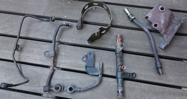

Postby Fetnas » Fri 04.05.2018, 13:56
As part of the head gasket replacement I've been undertaking, I've also tackled a number of rust issues and had a lot of the steel coolant and oil lines zinc plated and yellow passivated.
I also removed the oil cooler lines that go from the oil filter to the rubber hoses under the right wheel arch. I didn't get any before photos of these pipes. The rust wasn't bad, but considering the lack of access to them, I though it best to get them sorted now.
These bits look so much better after plating.

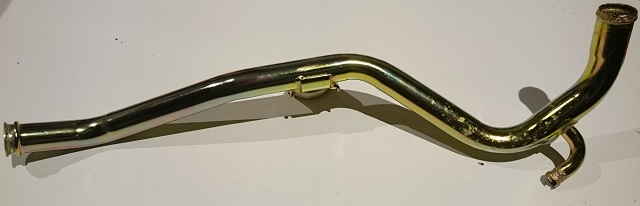

I also got the coolant bypass pipe that runs behind the turbo plated. I hadn't realised it was removable before I had the other parts done. It was probably a good thing I gave it the treatment as the rust was getting stuck into it. The small pipe on the side was worst for ware. I'll have to use a sealant on the hose joints to make up for the rough surface left by the dissolved rust, but I happy now I don't have to worry about rust in the cooling system.
