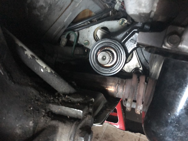

The cables come out through the interior, not the engine compartment. With the centre console removed and the four button crews (7) removed you can manipulate the whole cradle (15) out through the opening with the cables still attached to the lever mechanism (you don't actually need to remove the lever at all as it helps you to push the cables all the way forward and the lever all the way back to clear the opening) Its a little bit of a wiggle until you find the one position and it then just pulls out. Your cable may be sticking at the small opening between the firewall and the engine so it does help to have someone guiding/pushing them through. As mentioned tie a string a round both cables before pulling them into the cabin. This is what it looks like in engine compartment looking up towards the opening in the engine area and you can see its a little tight with the two cables on the gearbox end and it then takes a sharp turn over the rear engine mount arm.

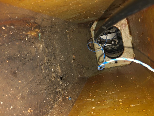

And this is how it looks inside the tunnel looking forward, you can see its very tight by the time you pull the cradle assembly (15) back far enough that the two adjusters on the gearbox end of the cables have to get through the opening.
