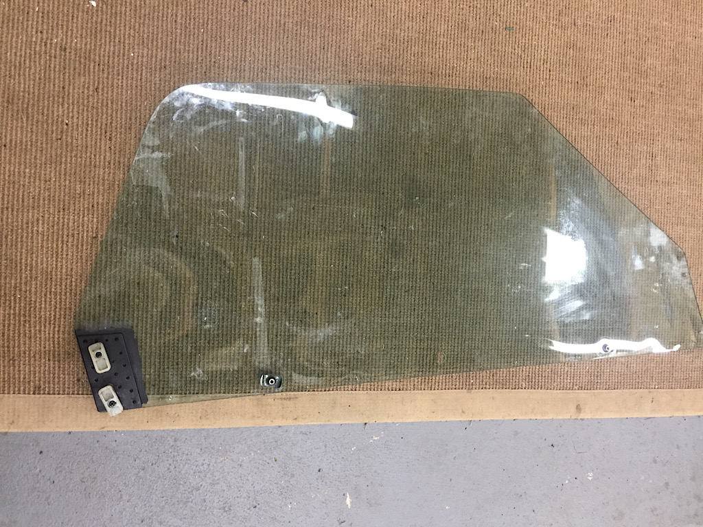

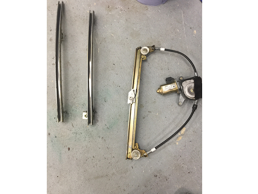

Yesterday I got my act together and stripped down the passenger door window (RHD S2). A bit of a struggle getting some of the bolts undone, but everything came out and I didn’t have to drill any of the screws. It was all very filthy, though, with a wide range of lubricants in the slider channels - MST of them completely unsuitable for purpose.
I spent the afternoon cleaning up, with a view to reassembly today:
Sparkly clean!

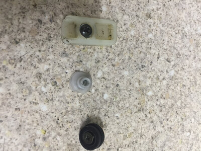

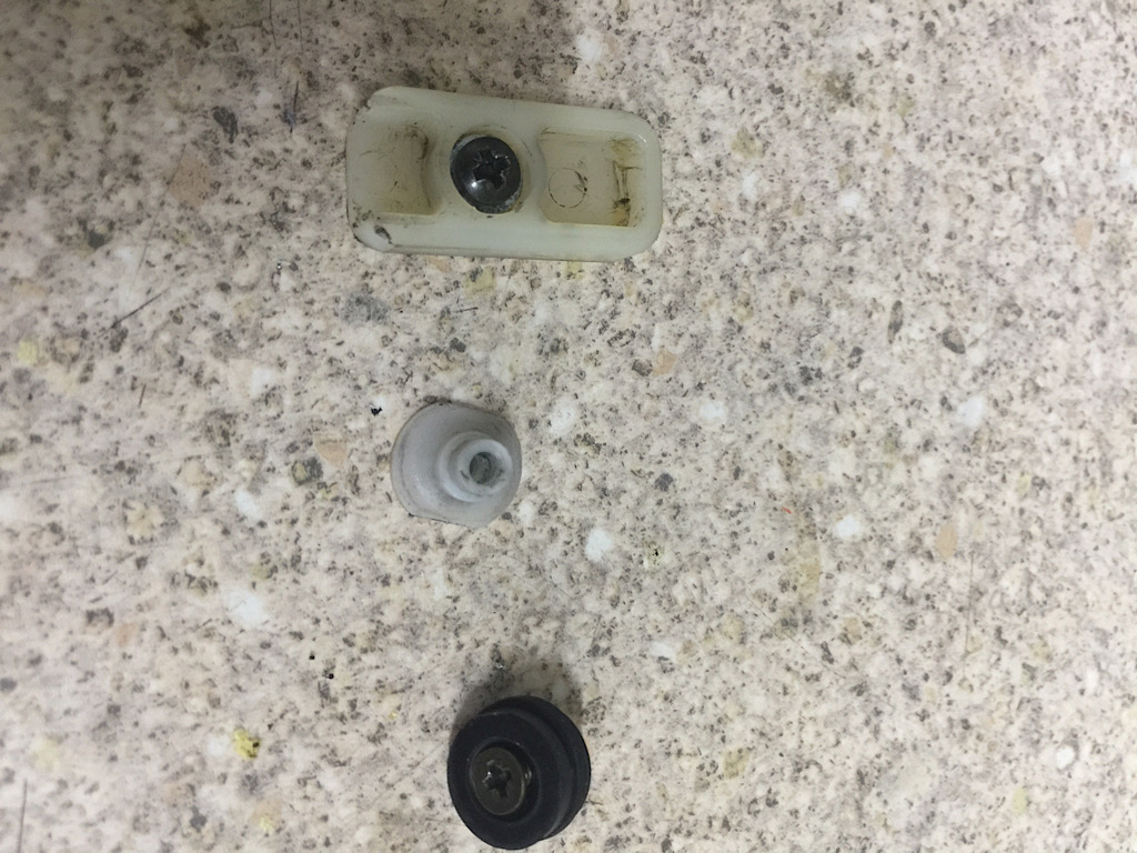

Unfortunately . . . When I took the sliders off the glass, to clean them up, I thought the upper front was a bit troublesome. And it turns out that the shorter thread has stripped in the centre boss:
Middle item is the one with a stripped thread
Why they couldn’t make it out of metal, I don’t know.
I did contemplate turning a couple up from some brass rod, but a) I didn’t have any the correct size, b) it’s a faff, and c) SJs can have replacements with me tomorrow. I’ve ordered a couple of lower ones as well - just in case.

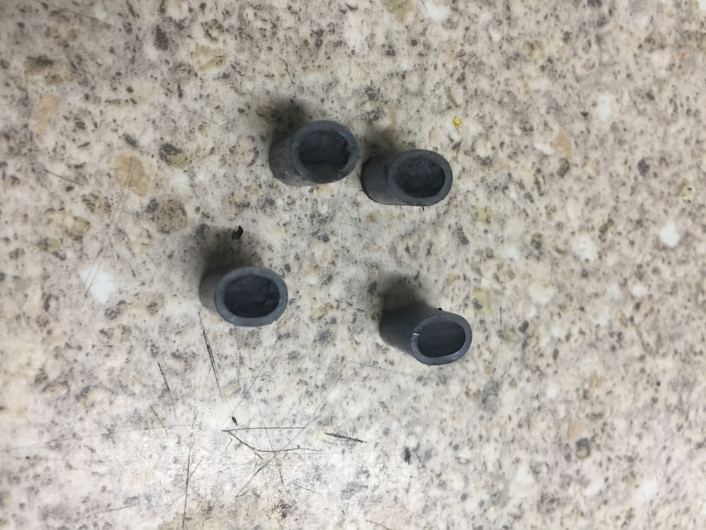

and I’ve started cutting some rod sections to replace the well worn slider bushes:
Looking well worn!

Yesterday was fun: 4 1/2 hours to replace the window glass in the door :roll:
After several (OK, many) abortive attempts I worked out that the problem was with the rear slider channel. It had fouled on a tiny protrusion of GRP in the door, pushing the channel outward just far enough that the slider would go in, but the roller was jamming at the top of the channel.
Having removed the window (again), a few careful strokes with a small file eased it enough for the channel to move inwards and the slider to go down completely.
That was enough for one day, so the window is now sitting at the bottom of the channels and later today I'll hopefully re-attach the butterfly clip and tighten the channels in their fixings.

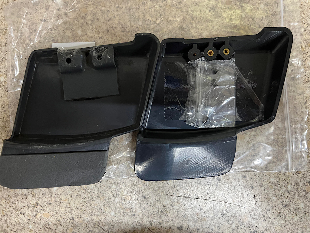

Latest Update: Over the summer I’ve been trying to repair my B post caps (the ones with the hinges). The original design is the worst kind of engineering bodge, with a piece of plastic used as a load-bearing member. I’d tried to repair and re-rivet them several times, without much success, and eventually decided to bit the bullet and buy a pair of new ones.
Big thanks to Mike Hopes at South West Lotus; parts ordered by phone at 12:30 on Thursday, and on my workbench by 1:45 on Friday. And what’s more, the new ones (which I think must be an SWL reproduction) are a far superior design - see photo below:
B post caps
Re: It’s only a small leak, honest
Postby Tuga2112 » Sat 26.08.2023, 22:25
it is interesting to see the different design.
my car has the original plastic only without a hinge design. i find it very clever but not suitable for the job. and the NA has the hinges as well but they look like a (i may say, good quality) DIY job which made me think about what to do about mine.
as things stand im more likely to end up 3d printing the replacements for my car than buying something off the shell.

Jonathan, I notice the foam strip on the old one -do tell more.
Postby Saltire » Wed 30.08.2023, 07:56
Simon_P wrote:Jonathan, I notice the foam strip on the old one -do tell more.
Interesting you should ask, Simon. It’s always been like that since I bought the car (coming up 9 years ago now). As far as I can tell, it’s a simple strip of waterproof rubber, a bit like what’s underneath the hood well floor (or Jamie’s seal material).
It never occurred to me that it wasn’t original, but having been out and looked at the car again, I suspect a previous owner may have added it to remove or reduce a rattle.
Both B post caps had one fitted :D
