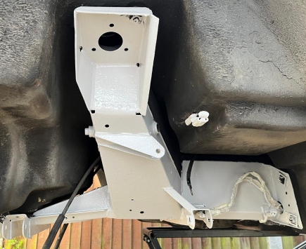

Rear of chassis and wishbones had lots of surface rust, so decided to de-rust and paint with Epoxy.

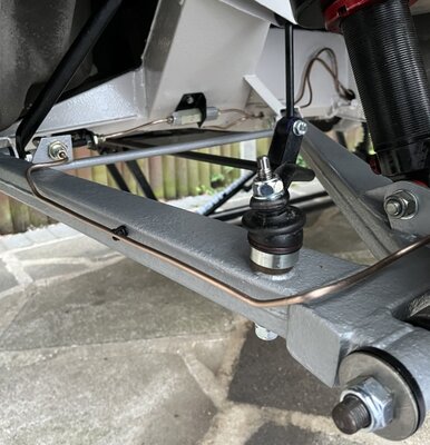

Dismantled brakes & pipes, pipes were rusty so decided to replace all the hard lines behind the chassis connection points to go with my shiny new flexible pipes.
Removing old bushes - tried pressing the outers out - Bent the wishbone! - Took wishbone to engineering shop to see if it can be straightened.

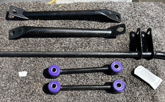

Cleaned up, Phosphoric acid treated and painted remaining wishbone, link stays, ARB, drop links and rear of Chassis.
Chassis After
Chassis Before
Other Bits
That's where I am now - Ready to re-assemble once the Chassis paint goes off and the bent wishbone is either straightened or replaced.

Almost there,
Thanks to Trevor (not THAT one), formerly of this parish who came to the rescue with a S/H Wishbone.
