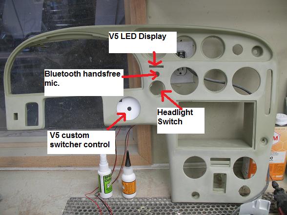

Geoff, as soon as Doug sends me the schematic I'll send it on itws way. I have a hand drawn one but I'd rather wait for the real thing. I should be able to mount the hazard switch now and connect up all the wires later. The pic below shows where the switcher and LED display are going. I think we need to stick with the original plan as the switcher is still a half foot or more away from the display.
So, display on some form of cable running to the little board for the display with pot to control intensity (this was a great idea Geoff) with another ribbon cable to the rotary switcher (I'm assuming no changes there so I'm using the one you sent) which will have a long cable to the ECU.

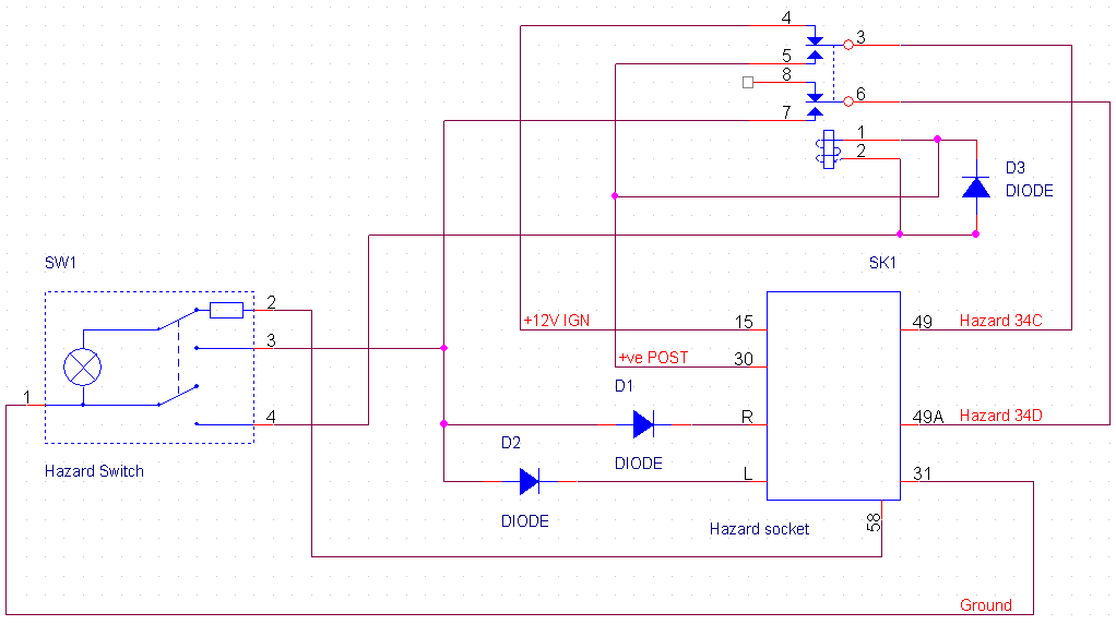

I've just been attacking my hazard switch and can confirm the following:
1/2 of the switch's function can be managed by a SPDT switch. The other half needs DPST. I am planning to use a SPST toggle switch that drives a relay. This relay will be powered from a permanent +ve and change over the power to the flasher from the IGN +ve to permanent +ve. The other pole will then connect flasher output to the indicator bulb circuits via diodes to prevent all the lights flashing when you just want to turn a corner!
In summary, you can use whatever switch you like, you just may need a relay as well. If I were you, I'd choose the best looking switch, then email Geoff the pin configuration. He'll probably then send you a solution in the form of a circuit diagram, as well as some bank details for an LEC donation :!:

The relay is DPDT, one pole swaps the flasher unit over from ignition pwr to permanent +ve, the other pole connects the flasher output to both indicator circuits via diodes (inside the black heatshrink sleeving) such that when you indicate with the normal system, the current cannot flow to the other circuit. The relay coil is on permanent +ve, the hazard switch is a SPST, grounding this coil. I could post a circuit diagram, but I can't think of an easy way of drawing it aside from with a pencil then taking a piccy of the paper!
As I said, with this system, any switch is usable.

The hazard switch is in and functional. Here's the diagram:
And the proof of the function (the red light is the warning lamp!):

Great minds think alike. :D I've wired in the SAAB hazard as per Doug's diagrams so that the background illumination is controlled by the rheostat module and it flashes at full intensity when the hazards are on.
Have you haven't ripped out the wiring for the old hazard switch socket Blair?
(12.46 KiB) Downloaded 68 times
Postby Elanlover » Tue 13.05.2008, 01:44
GeoffSmith wrote:you haven't ripped out the wiring for the old hazard switch socket Blair?
No good sir, the hazard socket (and all accompanying wiring) into which the OEM hazard switch normally plugs into is exactly as I left it. I was thinking that I'd wire up a harbess of sorts and just stick spade connectors into the socket where required. I'll look over the diagram post haste!

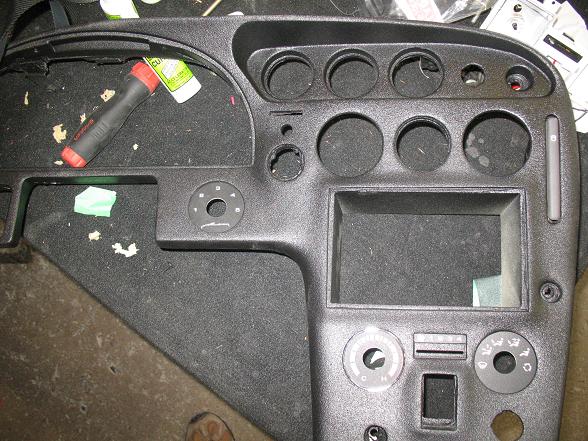

Postby Elanlover » Thu 29.05.2008, 00:13
Ok, we're making some serious progress as the pics below will show. I'm hopeful that, when I drop in tomorrow afternoon, we'll get all the gauges, etc. in and the dash installed and ready to go. Only issue will be testing the gauges to see how accurately I put the needles back on :roll: I think the voltmeter's pretty good, the oil may show a bit high and the tacho may show a bit high. No idea yet about the speedo or boost gauges. Oh yea, a few tell tale lamps aren't turnign on yet.....................did i just say we were almost done :banghead:

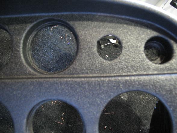

Fascia painted and we're starting to mount the various switches, dials and gauges.
Here's a close up of the texture of the finish.
With the fascia sitting in place to test out the head unit connections.

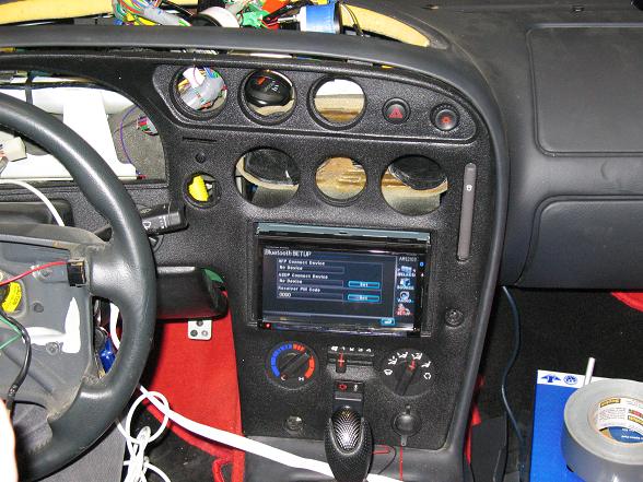

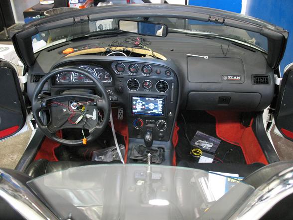

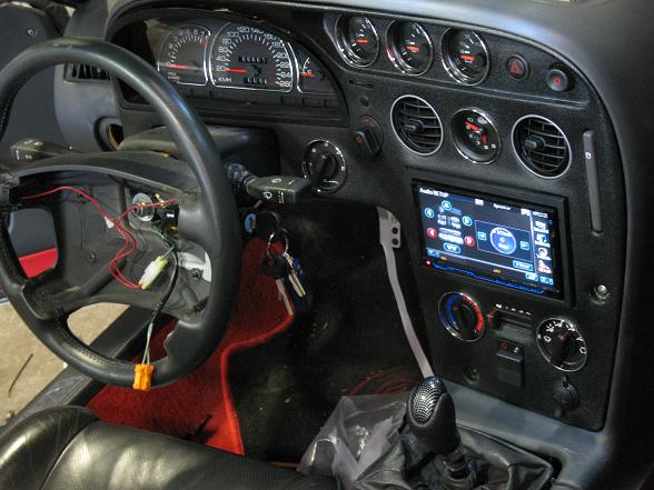

Postby Elanlover » Sat 31.05.2008, 02:42
Ok, serious progress now as the pics below show. I have a few issues to resolve as yet.
1. I'm not getting all the telltale lamps lighting.
2. In order to fit the speedo cluster over the new switches we had to chop off the lower fixing tabs and bolts. Unfortunately, the speedo now dangles with no support.
3. No matter what I do I cannot get the tach needle set properly. I've taken it off 6 times now and every time it simply doesn't want to calibrate. This last time it looked like I had it bang on. Howver, after starting the car a few times the needle is showing wat high again. It seems to be slipping on the "pin" somehow.
4. I may be getting transient signals as the check engine light seems to glow very faintly and now the temp needle doesn't return to the rest point :evil:
Other than that i guess its turning :roll: out ok..........................

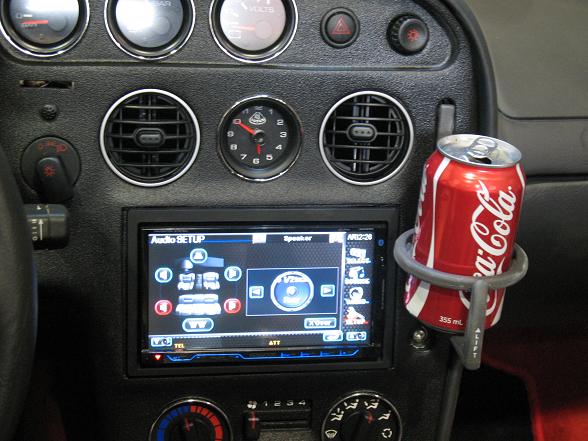

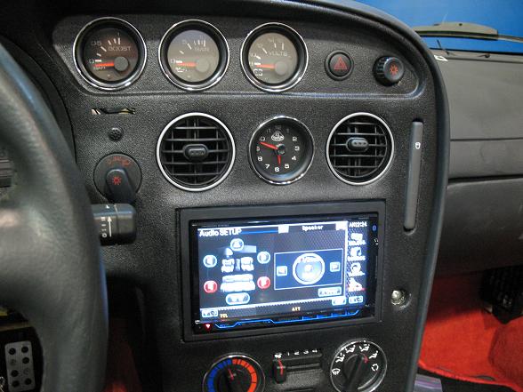

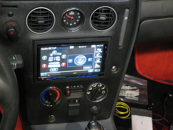

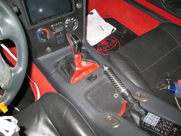

Up close and personal with the new dash. I really like the clock where it sits.
How about an ariel view.
Good shot of the V5 switcher dial to the left by the wiper control stalk.
And another full frontal view.
And the wonderfully working cup holder too! Should have been a beer though after this amount of work.
With a few little accents now installed.

Postby Elanlover » Sat 31.05.2008, 15:06
Monty wrote: They've done a great job moulding/shaping to the LCD screen

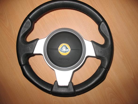

Yes, I was particularly happy with that aspect as the old stereo single DIN hole and square vents jut out a fair bit from the fascia. These are now flush mounted which provides quite a bit more room actually. Makes the cockpit feel just a tad bigger. Once (everyone cross their fingers) I get the few nagging problems resolved I'll be moving on to trying to fit the Elise airbag steering wheel I have.
