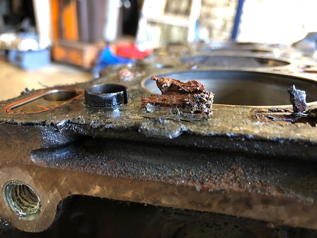

In puzzling news, the head gasket appears OK (apart from a large lump of crud sticking to it), but three of the exhaust valves are stuck open and won't move :banghead:

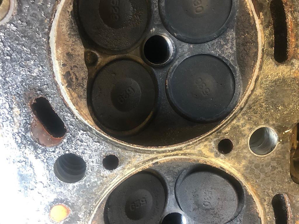

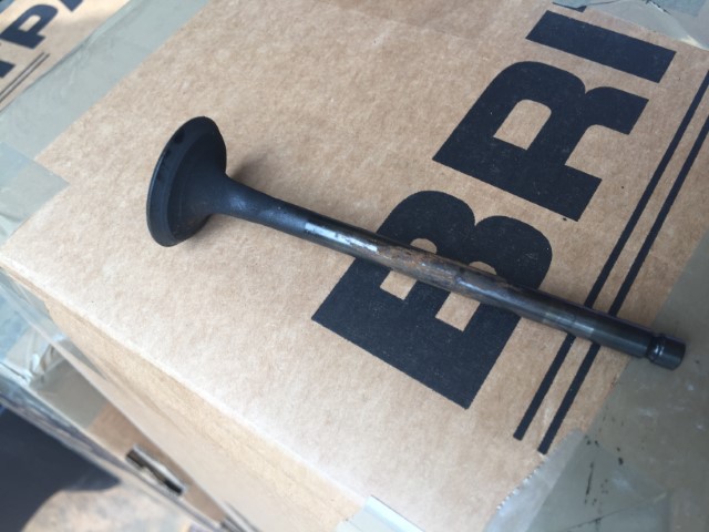

And in other news . . . . The head is stripped, and I now know what the problem is:
Cylinder head ready for stripping
More fun than Lego Technic!

Here's the gasket - no nasties between 2 and 3

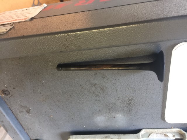

Here's the evidence:
Valve showing rust 1
Valve showing rust 2
The three offending valves all have light rusting on the valve stem. It's not significant corrosion - you can scratch it off gently with your finger - but it was sufficient to cause the valves to be stuck pretty firmly in the head. I had to resort to a little gentle 'persuasion' to get them to slide out.
What I don't understand is why the valve stems should be rusted at all. I've not checked all of them carefully yet, but it's a puzzle.

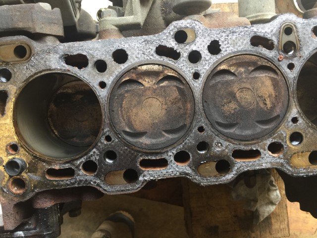

Anyway, the good news is that the block and pistons are fine:
Top of the engine block - no damage apparent

Postby dapinky » Tue 09.06.2020, 17:01
Jonathan,
I had assumed that the cam was out (otherwise the valves would be open in pairs) ........... but I still slapped myself around the head and thought "why did I not check that?" :roll:
However, my thoughts now are :-
If the head gasket has gone, coolant will be getting where it shouldn't - and if it has got into the combustion space, it may have gone up past the valve seats (whilst the engine is at rest, with valves open) - and then caused rust on the exposed valve stems.
The good news is that this indicates that the rubber valve stem seals are doing their job and not allowing oil to drip down the valve stems. (although it may have been better if they were leaking a little bit!!!!).
This isn't a definite thing, just a possible thought..... who knows where the water has come from (it can even just get in from the ambient air humidity).
Either way, it should all clean up okay....... and when the head is stripped, it is an ideal time to whack it in the dishwasher to make sure all the crud is out of the passageways :D

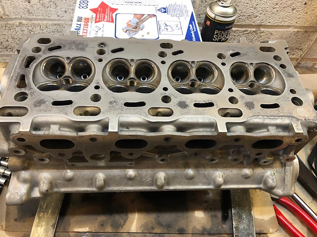

Postby Saltire » Fri 12.06.2020, 13:37
More good progress in the last couple of days:
Nice clean head
Valves being lapped in
Head surface checked and reassuringly flat

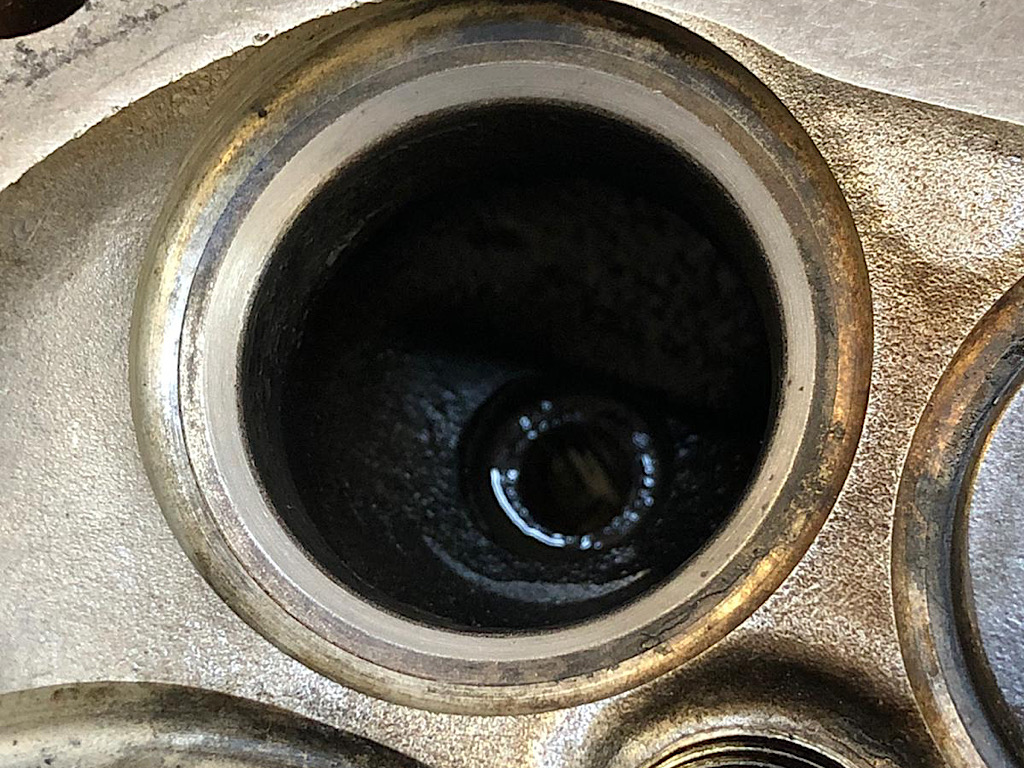

I was surprised to see that the valve guides are steel - I hadn’t expected that. Has anyone else found anything different on this engine?
Now awaiting parts from SJ and Kelvedon before the reassembly starts.
EDITED: Thanks to BCN for pointing out that I had written “valve seats” when I really meant “valve guides”. D’oh! :bonk:
