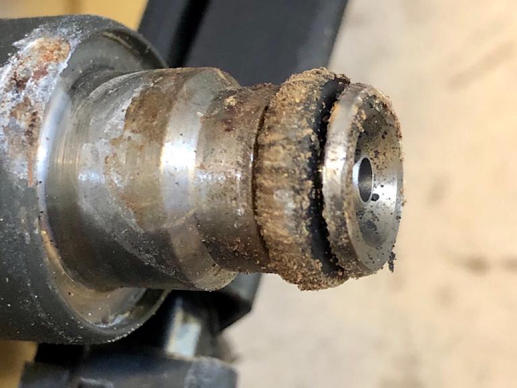

Waiting for parts, so thought I’d idle away the afternoon checking and cleaning around the plenum chamber.
Who knew an Elan would run so well on chicken droppings? :roll:
Fuel injector O rings after 65,000 miles
New O rings on order

Its one of those if Aldi did fuel this is what your injectors would look like moments :D Which is even more worrying because I quite like Ald :D

I always use V-Power or Momentum 99, but of course no-one knows what the previous three owners might have used.

That's what water does to aluminium, not rubber it might just brush off or you might have to pick it off.

Simon_P wrote:That's what water does to aluminium, not rubber it might just brush off or you might have to pick it off.
Brushing doesn’t work, but new O rings are cheap :-D

I was more concerned where the water came from. Is that injector for cylinder 2/3?

Looks like it has been sitting in water and its got past the O ring.... From there into the cylinder...
Is the washer jet pipework leaking?

The injector has been sitting in water, the water has caused the aluminium to corrode which has breached the O ring seal, from there its down hill from the inlet to the valves and you're there.
The only regular source of water above the injectors is the washer system. All guesses without looking.
It looks like a long term issue given the corrosion.
Also odds are against it being water in the fuel, the pump is at the bottom of the tank so any water would soon go through the combustion process. It would also affect all cylinders.

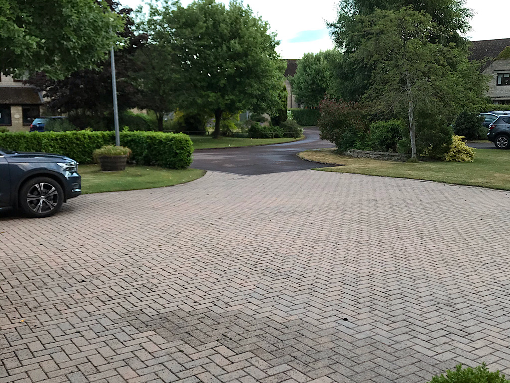

Jonathan, does the last part of your regular journey involve going down or stopping on a slope?

Wondering out loud if you (or anyone else who has worked on the car) Has pressure washed the engine and/or engine compartment? From the Pic it looks like the water has traveled down and was sitting on the lower O ring, then past it into the intake (did you say this came out of the two cylinders with stuck valves? Also when were the injectors last out? seals re-used? and what type of lubricant was used on the O ring to re-install them? Just musing.......as that kind of rust on the valves is very unusual on an engine that was running fine a short while ago. As per previously posted pic that squirrel P*ss is very acidic :smt119

    - And finally, the driveway is flatter than a flat thing, and the car lives in the garage overnight:

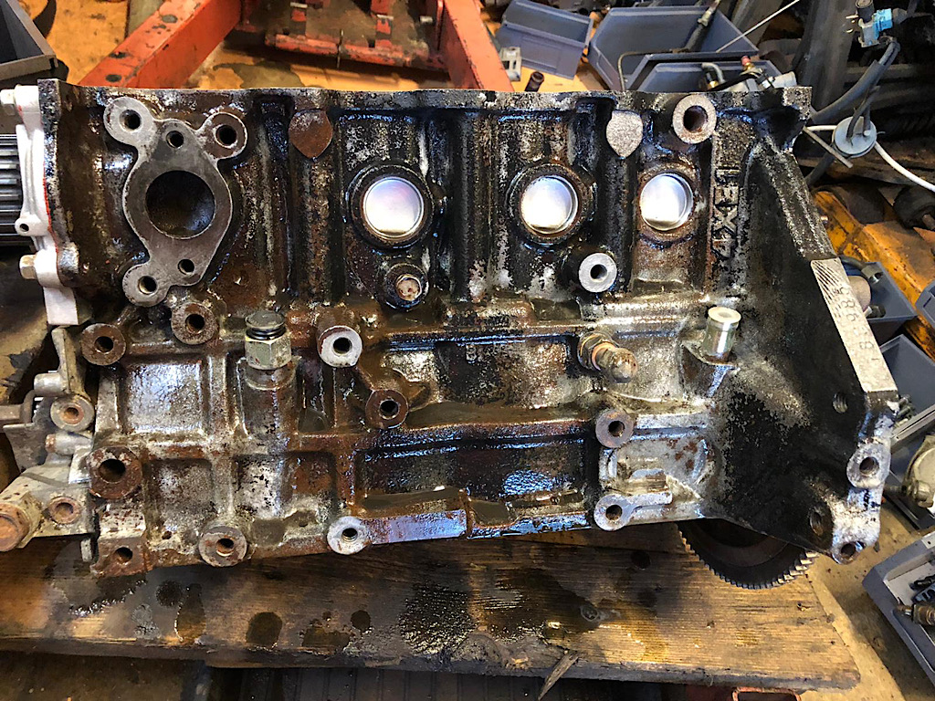

Good progress over the past week, culminating in the new hydraulic tappets arriving from BCN in the US; thanks, John. Still waiting for the engine parts from SJs and Kelvedon, but in the meantime:
Engine degreased - you can even see the number matches the paperwork!
Top of the block looking good as well

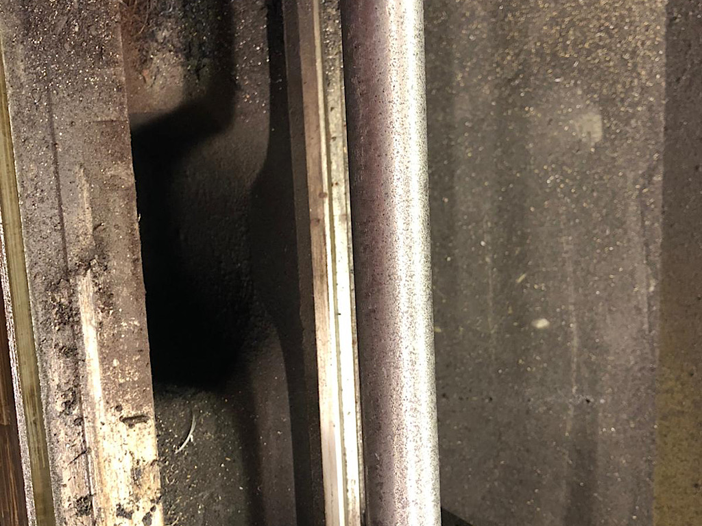

Cleaning the rusty driveshafts - before . . .
. . . and afterwards
Roll on next week when the parts arrive and we can start the reassembly :D
