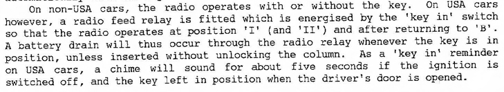

Postby donsladek » Wed 07.11.2018, 01:21
The "lights on" chimes on my Elan sound the same as these described in the Electrical Manual, page 4, which alert the driver to keys left in the ignition. However there are only 4 radio "dings" vs 5 "dings" for the lights.
This is described on page 8 of the Electrical Manual:
Excerpt from Page 8 Electrical Manual on USA cars and Lights On warning chime.jpg
