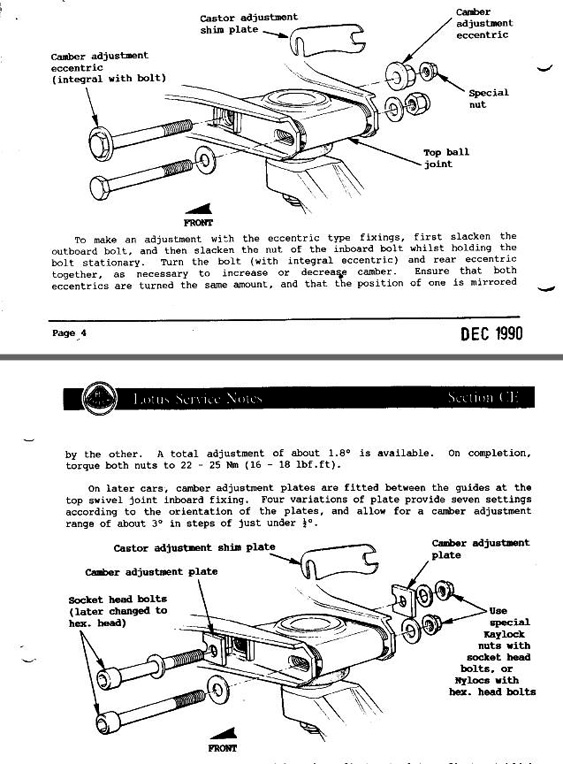

Have you checked you have the early eccentric hex head bolts? It's the inner bolt that has the eccentric shoulder under the head. Got the impression they were phased out about the time the Anti-lift angle on the rear was reduced so only a couple of hundred made using that system. If they are socket head bolts it will have adjustment plates. Section CE.3 (Front Suspension) shows the early eccentric hex head bolts were replaced by socket head bolts with adjustment plates but the Section on Driveshafts was never revised to reflect that - the plates need to go back where they came from so it would have been useful to have included that info'. Agree with Fredjohn - don't just throw them all in a box.
Either way, don't worry - my local Lotus people, Hanger 111, only charged me £25 for a full geometry check, plus a bit for adjusting the track rod and rechecking geo'. If you do have the 'eccentric bolts' you can mark it with tippex to put it back how it was but it may already be wrong because a previous owner has messed with it. I'm sure you can find somewhere local to do a 'geo check' - be a good idea to have the car checked anyway, particularly if you don't know the history of your car.

Bad news is. My bolts are hex ones, not to mention I need to swap them because the Allen key I used to try and turn them with ended up rounding them.
Luckily the air hammer did the job of taking them out. And the nuts did came out before the bolts rounded
I have only got one side out so far. And I lost the measurements when undoing the bolts as only after they were out I realised where I was supposed to make the markings.
I'm willing to pay that fee for the job, seems actually a very fair price. So I guess I'll just make sure to count the shins on each side and then put it back together. Let the professionals deal with the adjustment

:smt017 The early eccentric hex' bolts had a conventional male hex' head that used a spanner or socket on it. Check the manual pictures ...
If you used an Allen Key then it sounds like you've got the later Socket Head Bolts (the Socket is a female hex') and those use the adjustment plates so not necessary to mark it's position.
With any bolt & nut it's 'good practice' to hold the bolt and turn the nut using a hex socket, not a bi-hex. Once the nut has turned a bit the bolt may need to be held to stop it turning but that won't cause much damage to the head.
Front suspension bolts can be rusted pretty tight in the ball joint casting and after the nut is loosened may need tapping free. If you try to start by turning the bolt before the nut is released, or it's tapped free, it can damage the head.

your right, i did have some shims there that all i had to worry about was their orientation.
i will re-read your comments about best practice ref undoing bolts/nuts.
what happened to my bolts was the nut part came out without need to even put a alen key on the bolt side. but when i was trying to remove the bolt, i used the alen key to free up the bolt from the mounting but the thing was soo rusted in place that the female hex rounded out.
i ended up using a air hammer to free it up. but it took quite some time persuading it. i did put the nut back in before using the hammer in order to avoid damaging the trheads at the edge. but bottom line is that i will be replacing those bolts instead of going back in.

If you are replacing the bolts, note that the inner and outer ones are different lengths - so you will need 2 x M8x70 & 2 x M8x85........
....also, make sure that they are HT bolts (10.9 minimum, but 12.9 are better) - NOT 'standard' HT bolts of 8.8 rating.
Usually, hex headed bolts are 8.8, and the higher strengths are allen headed bolts. (but you can get any configuration if you look hard enough and/or get them made).
Something like thesewill be good or these(and if you can't find 85mm ones, then 80 will probably do)
Posts: 10578

Tuga2112 wrote:Thanks Dave,
I did notice there was 2 different sizes.
I became aware higher tensile strength bolts are "always" hex/allen key ones when i was in a pickle with the bolts for the front caliper. (remember ? :lol: )
Not trying to cause any grief, but they make high tensile strength bolts in hex head too. They will have marks or numbers on the head that denote the strength.
For the record, High tensile strength bolts have great clamping strength but they are also much more brittle and they will shear instead of bend (like the lower grade bolts) when something tries to bend them (hitting a ditch at the side of the road is a good example as it will usually try to push the suspension rearward which often shears the bolt instead of bending it).
