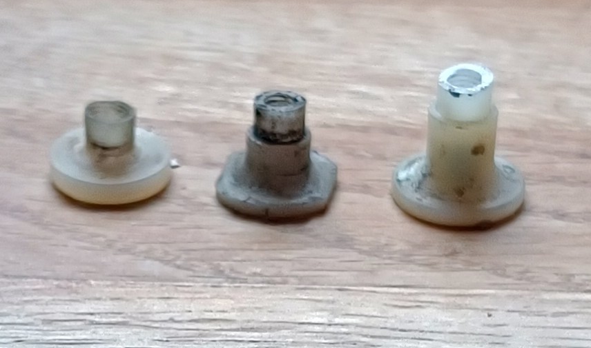

Decided it was best to remove all the guides as they were very sticky with all the old hardened grease, and the motor came out to.
Looking at all the window fittings something didn't look quite right , ALL the rollers were missing. And then as i cleaned the 'bits' that unscrewed from the window it again looked odd.
Watching Tobys excellent Elan Restoration Series videos i was very confused as to what i had !!
I think the one on the left is original and the shorter version of what is needed. I think the two on the right are imposters !! They don't even fit through the glass :roll:
I've ordered loads of new bits, screws, rivets, clips, seals, fluffy bits, etc, etc, I think i'm up to about 250 quid on parts from SJs just to stop the door/window rattling :-D :-D !!

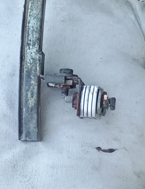

Oh - and does this really need FOUR spaces on it ?! Surely a larger bracket on it would have been better with the option of one or two spaces maybe ??!! :-D

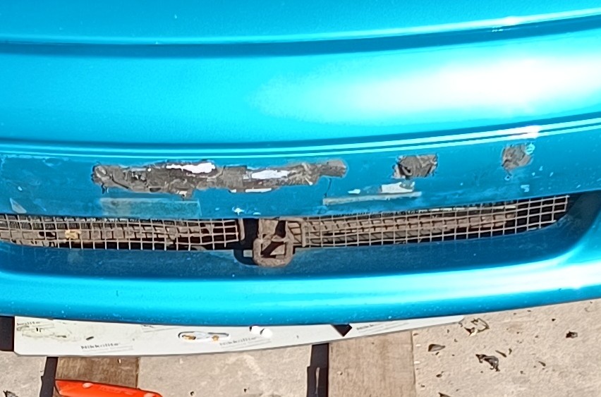

Oh - and battling to get all this crud off from behind the front number plate. God knows what has been put on here , there is 3/4 layers of various stuff on here - some has already been taken off. And the HUGE blob of blue tack had already been removed :wtf: :roll:
