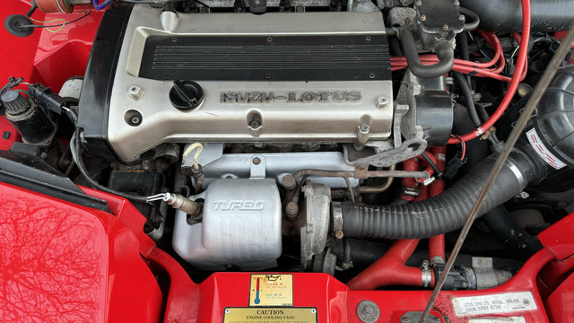

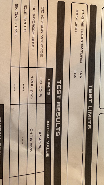

As of this aft, I have successfully installed the O2 sensor that I bought years ago. Unfortunately I did have to add the wiring which was a tad stressful as I was afraid of blowing the ECU.
What a difference! The obvious is the extra power but the delivery seems smoother and on lift off the run down is so much smoother. Less pops and bangs though :(

Last years emissions
This years
Before
It’s time to get serious
After

Your CO emissions improvement pretty much reflects the improvements I got, when I went closed loop. Makes the MOT so much easier to pass.

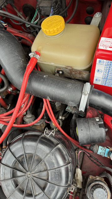

Postby nicowalker1 » Fri 19.04.2024, 18:33
A little bit of tidying under the bonnet.
Really need to replace the insulation as it’s a mess

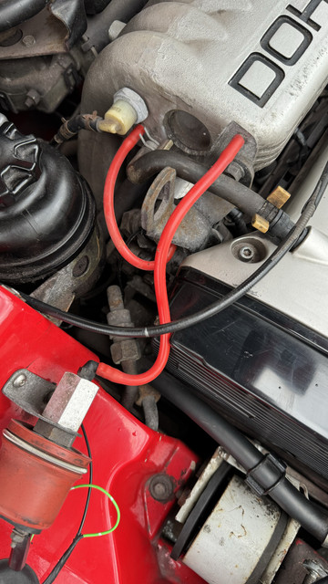

Postby nicowalker1 » Fri 19.04.2024, 18:37
A few vacuum hoses replaced. I still have the boost issue…
The boost gauge does sometimes go up to the expected level but only for a split second then falls back to 0.5.
I checked the other hoses for signs of leaks and can’t find any sign of perished hoses or leaks.

Postby Tuga2112 » Sat 20.04.2024, 15:30
nicowalker1 wrote:A few vacuum hoses replaced. I still have the boost issue…
nick.
Check the ground wire on the "sensor" (i know its not a sensor technically but the name of the part escapes me at the moment) near the power steering reservoir.
make sure the wires are connecting to the "thing" corretly and with clean connections.
if the boost is working and its only the reading that is not appearing in the cabin, thats an easy thing to from
