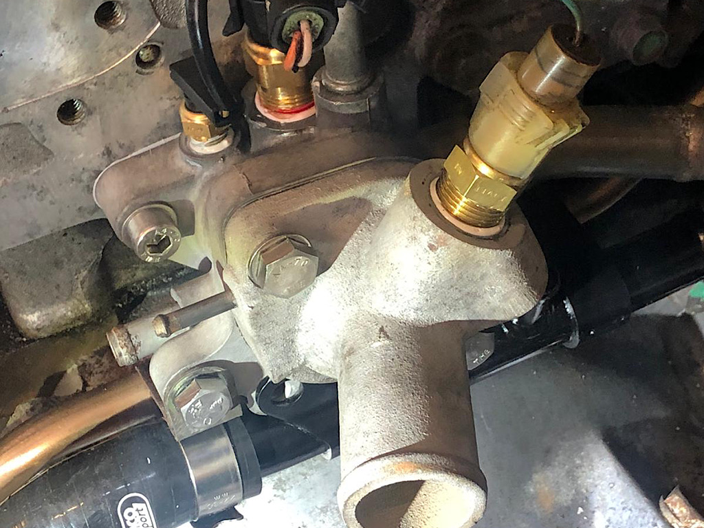

New thermostat and temp sensors, housing cleaned

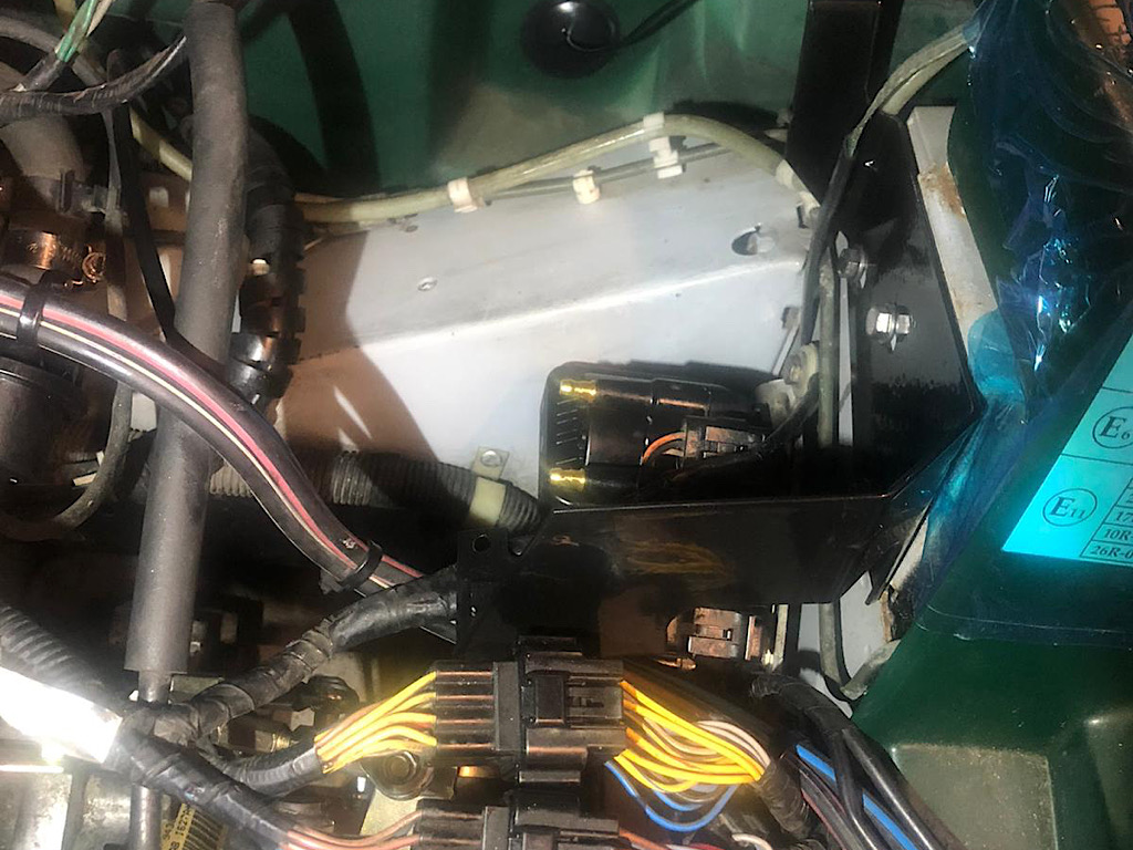

New coil packs and controller; powder coated support bracket

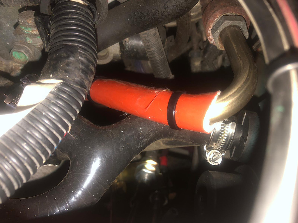

Beginning to fit the Samco hoses from last years group buy. Red part is high temperature shield over EGR pipe, to protect the Samco hose

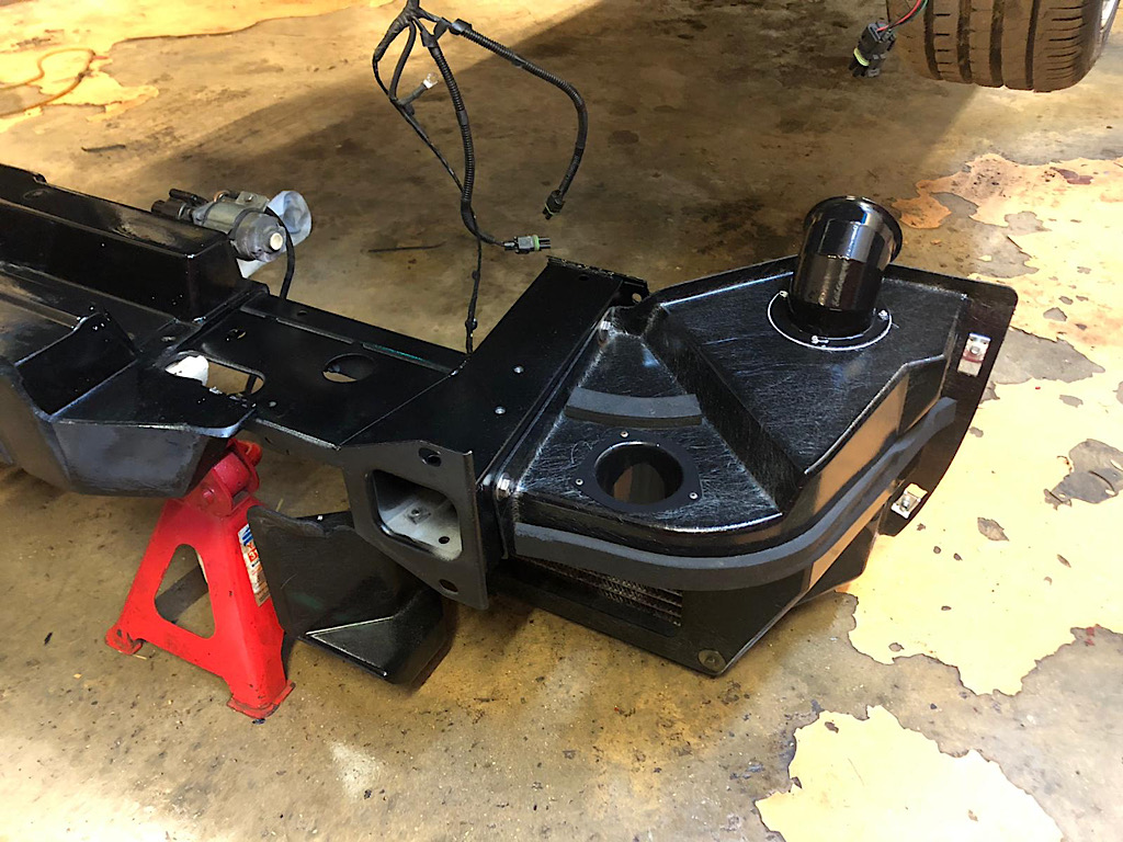

Building up the refinished cross-member; note the new stainless fasteners and the powder coated air intake

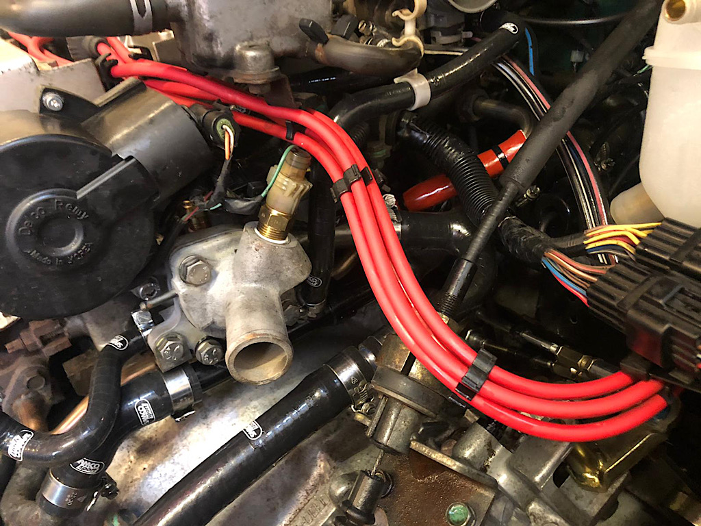

New plug leads in and routed

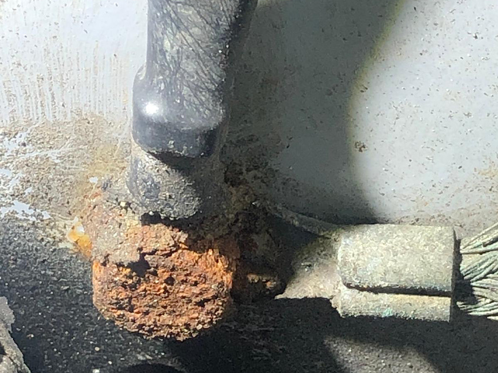

Who was it who was asking about chassis earth a while ago? This is the ‘before’ image

PS after you have fitted the rad. and added coolant check carefully for any leaks. After fitting the new Samco hoses (twice now) you usually get a small weep after a period of time. Easily sorted though, particularly if yo have easy access underneath

Thanks Mark; now you mention it I recall seeing that somewhere, but I’d forgotten. Sound advice :bowdown:

Only real hiccup was that the new temperature sender put the gauge into the red at the top of the scale. IR thermometer showed water well within limits and fans didn’t kick in, so tomorrow’s job is to put the old (working) sender back.
