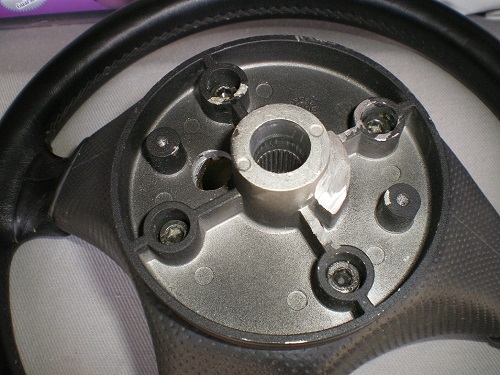

Elanlover wrote:A custom hub by he who shall not be named was required. The Elise hub does not fit the Elan column. At least not on the Fed car. Can't speak for UK versions.
Hmmm, i bought an Elise Nardi wheel from ebay UK and it was a direct fit (other than removing the Air bag clock spring and grinding down the auto cancel nub) on to my 91 Fed Elan ?? :?

Postby Elanlover » Sat 08.04.2017, 00:16
So no airbag and no horn? The BB hub was designed to use the Elise airbag steering wheel with the stock clock (no pun intended). Works well but I have to say that its almost a bit small for my liking. Better than the huge stock 18 wheeler job they used though.

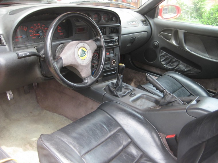

Postby LotusEnthusiast » Mon 10.04.2017, 01:24
I gave the Elise S1 steering wheel and the original federal steering wheel to LGM. She ended up cutting out the boss from the original steering wheel and welding it to the steel compression boss on the Elise S1 wheel.
This was by far the best thing that happened to my Elan. I'm 6'5" and with the original wheel, every time I tried to turn, my hand would hit my knee so it was tough to enjoy sometimes. With the Elise wheel I have no problem and it feels great! No airbag, but the horn works and I got the airbag light to go off with a diode.

Postby esprit888 » Mon 10.04.2017, 01:47
Elanlover wrote:So no airbag and no horn? The BB hub was designed to use the Elise airbag steering wheel with the stock clock (no pun intended). Works well but I have to say that its almost a bit small for my liking. Better than the huge stock 18 wheeler job they used though.
No airbag but horn worked fine. I am confused though as i didn't need to cut anything, just grind off the indicator cancel nub. I seem to remember something about there being two types of Elise Euro steering wheels (or was that the M100 :lol: )
