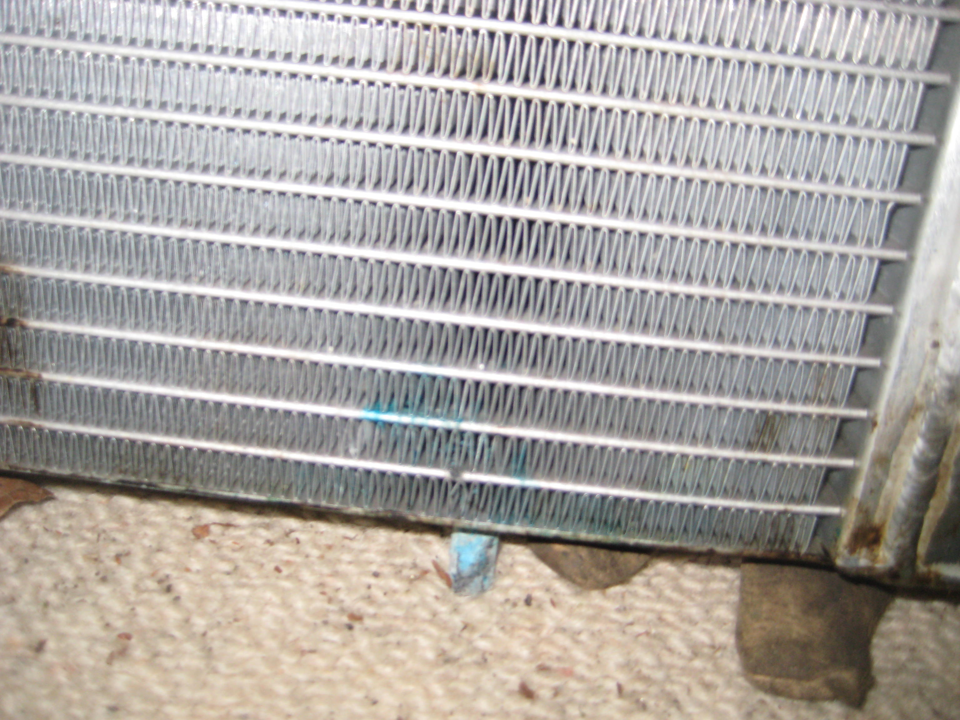

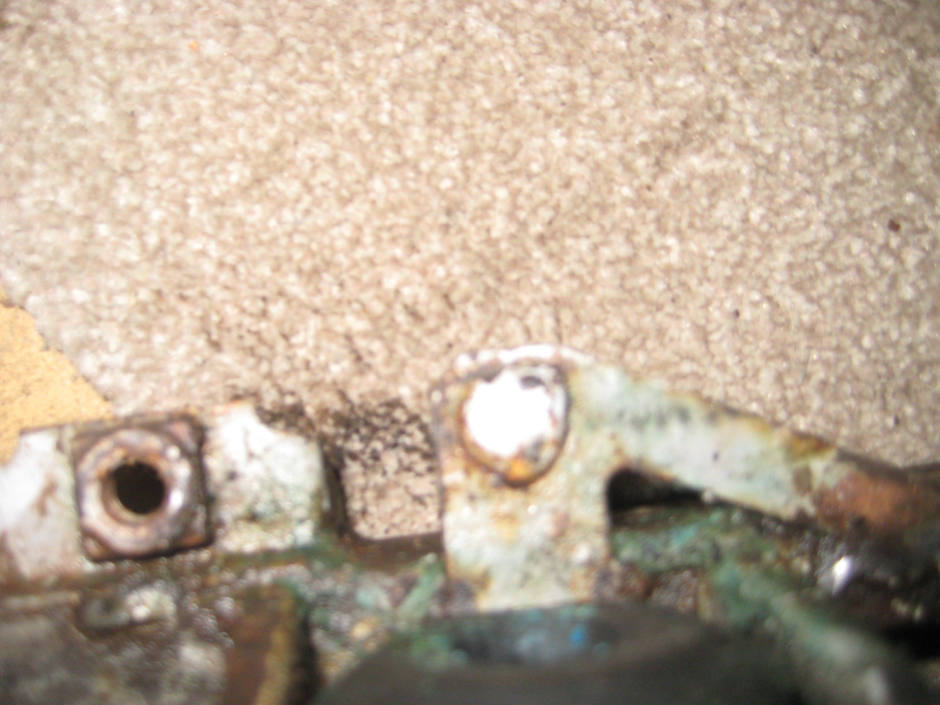

Well I got to the bottom of the radiator leak, There was a 'spike' of weld on the rad frame.
When I moved the rad towards the rear of the car as I jacked the engine slightly the spike punched a tiny hole in the rad.
The spike shows up as yellow in the poor picture and the leak is above the blue cloth.
Took my bastard file to it and all will be well.
Oh the joys of Elan ownership.
ETA ..and yes, my garage is carpeted.
