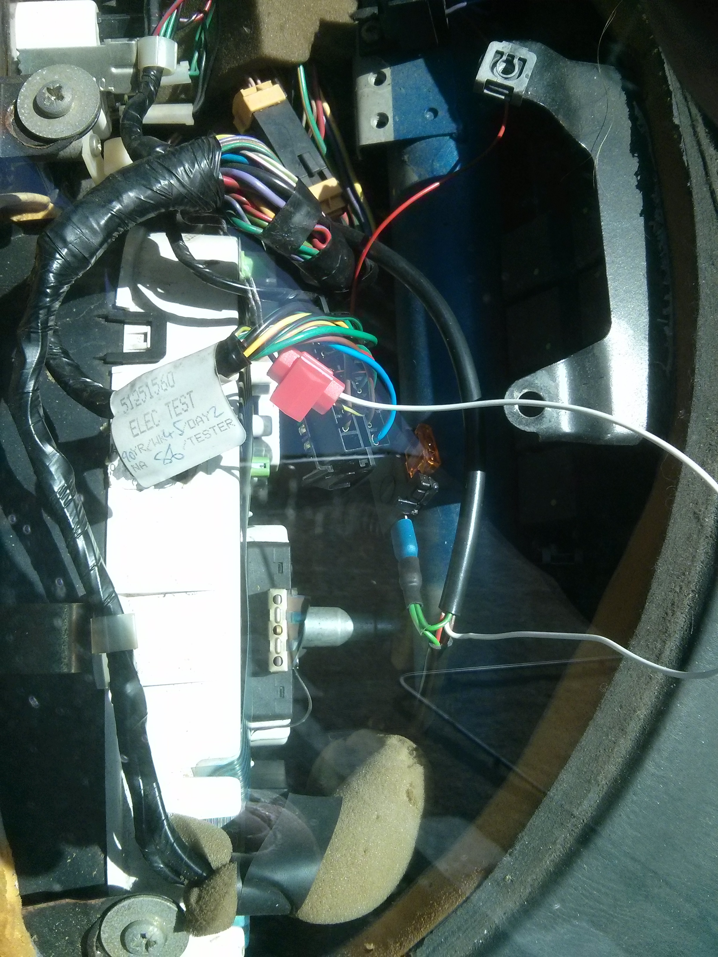

The speed input wire that you want is a black/yellow wire from the back of the instrument panel (it goes to the ECU) and it is easiest to just splice the White wire in the 7-core cable onto it with a Scotchlok.
The ignition controlled 12V that I used was from the unused AC blower fan relay socket under the dash cover – just used a male spade connector and inserted it into the socket for the relay (Light Green wire with Green trace). Join to Green in the 7-core – with a 5A inline fuse, and also to pin B on the control stalk – unless you want to get 12V from somewhere else).
The Green/Purple wire at the brake switch is the one to Scotchlok to the Black in the 7-core cable…. It isn’t at all easy to get at, you can feel it, or see it, but it’s hard to do both – perseverance is needed.

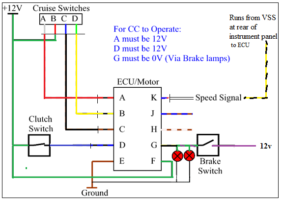

Okay, onto the control stalk – as well as the ‘standard’ main plug connector for all the Elan stalk functions, your ‘new’ stalk will have 4 wires going to a small socket. If you are fortunate enough to have got the plug bit that goes with it, great – but if not, just chop off the socket and join the 4 wires singly.
You will notice that the 4 wires from the plug look similar colours, but they have different trace colouring – which (co-incidentally by amazing good fortune, blind luck or actually sort of thought about intellect!) are also the colours of the 3 wires in the 7-core cable :D .
As such, the wires connect:-
Black/Red (Pin A) goes to Red
Black/Brown (Pin C) goes to Brown
Black/Yellow (Pin D) goes to Yellow
Black (Pin B) goes to 12V from wherever you get it – I used the same 12V supply from the AC relay socket.
However, if you didn’t get the plug with the stalk, then the 4 wires on the socket (stalk end of the connection) are not the same colours as above and equate to:-
Grey (Pin A) goes to Red
Blue(Pin C) goes to Brown
Green (Pin D) goes to Yellow
Red (Pin B) goes to 12V from wherever you get it.

One more wire to go, and then we’re done. This is the one which takes a bit of ingenuity (or you could say bodgery, adaptation or just hopefulness)…
The unit relies on a number of factors to enable the Cruise Control to work – the speed signal not only sets the unit at the desired speed level, but also ensures that CC can’t be set at too low a speed (approximately 50kph/30mph). Also, that the unit switches off if the brakes are applied. The final bit is that the unit switches off if the clutch is depressed.
This is basically to stop the engine revs rapidly rising when you dip the clutch. It relies on a constant 12V to be seen at Pin D on the CC ECU, and the clutch switch interrupts this signal, and turns off the unit. The switch is closed when the pedal is up, and opens when the pedal moves (opposite to the brake light switch), and in a Vectra is fitted to the pedal box above the clutch pedal (one of these). However, the Elan doesn’t have the wiring to fit it, and the pedal box isn’t designed to accept one….
The options are to find some way to fit a Vauxhall switch, and attach the wiring to it, find an alternative (one of these?) and fit it somehow, find any suitable release-to-break switch and mount it (something like a smash-glass-to-sound-fire-alarm thingy??)…….
…….OR…….
If you think that you will never dip the clutch whilst the unit is on (I can’t remember ever doing it in any of my other cars, but maybe I have), then you can just connect your Blue wire to a 12V feed and it’ll all work fine…..
…but as I didn’t trust myself (or any other driver) to remember to switch it off before operating the clutch, I decided that a simple reed switch would do the job.

Circuit Diagram
Pin out
