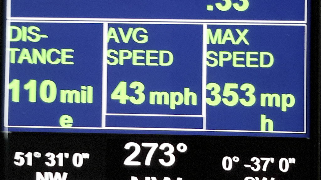

I'd fitted a HUD GPS speedo so was using GPS speedo on my phone to check calibration and phone says top seal blew off at 353 mph .. honest.. :lol: Here's proof..
(It's the M25 Holmesdale Tunnel that confuses GPS :lol: )

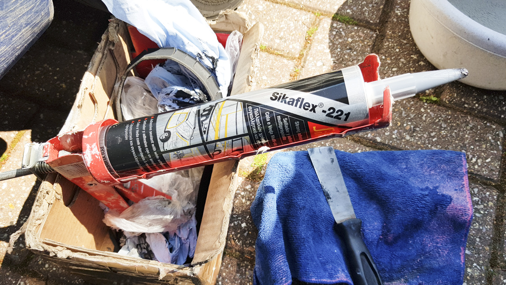

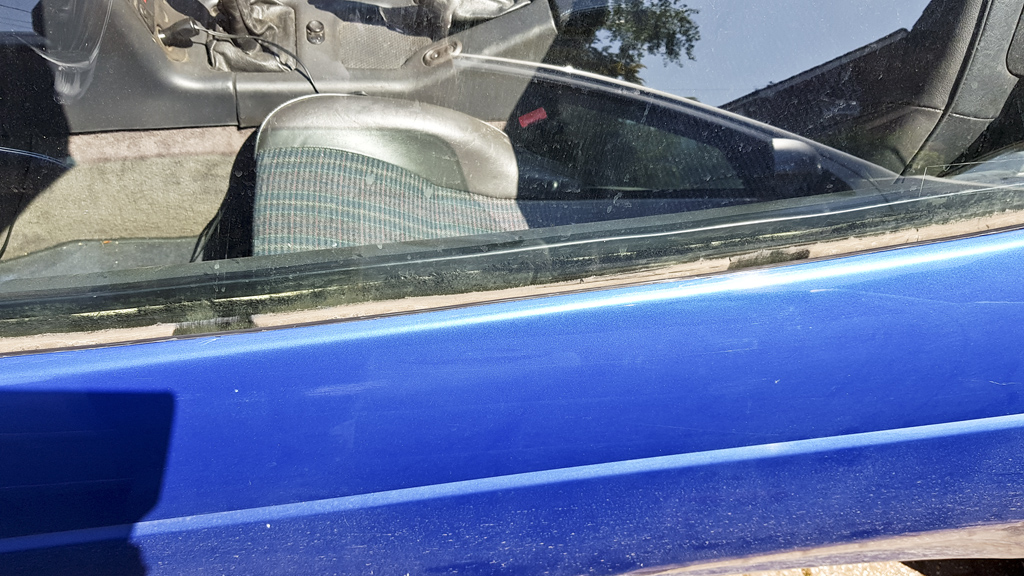

Anyway, I used Sikaflex to re-attach screen top seal using only a small proportion and thought this won't be any good in a few weeks, what else can I use it for... decided to see if i could fit the new window seals using it.

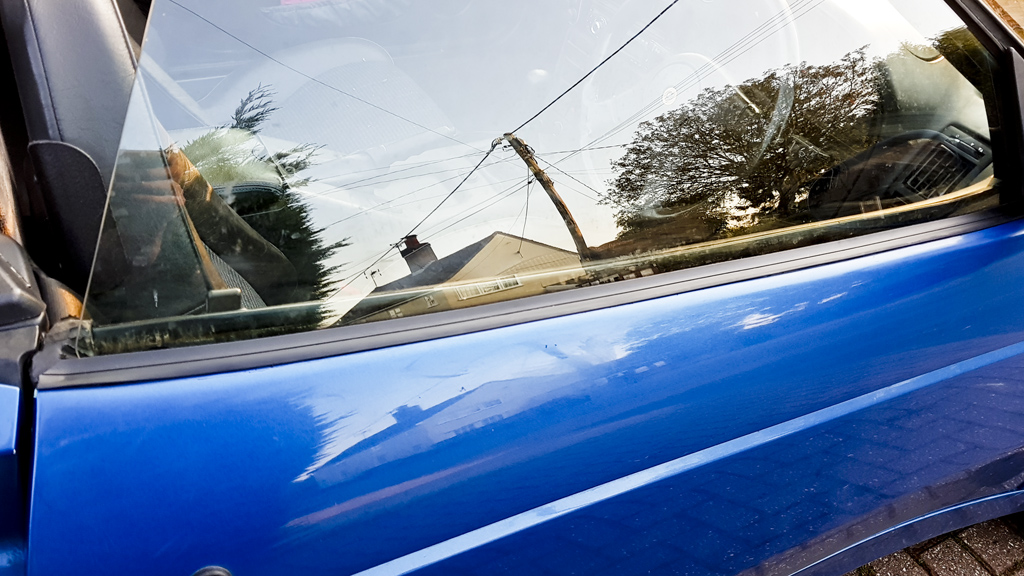

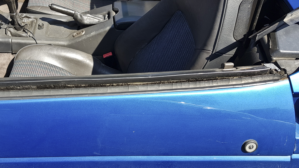

This what I started with ... very hard and cracked... and not sealing at all..
Cut all the rubber off with a 'Stanley Knife' to expose the bare metal strip... (amazing how dirty the glass is just behind that seal)

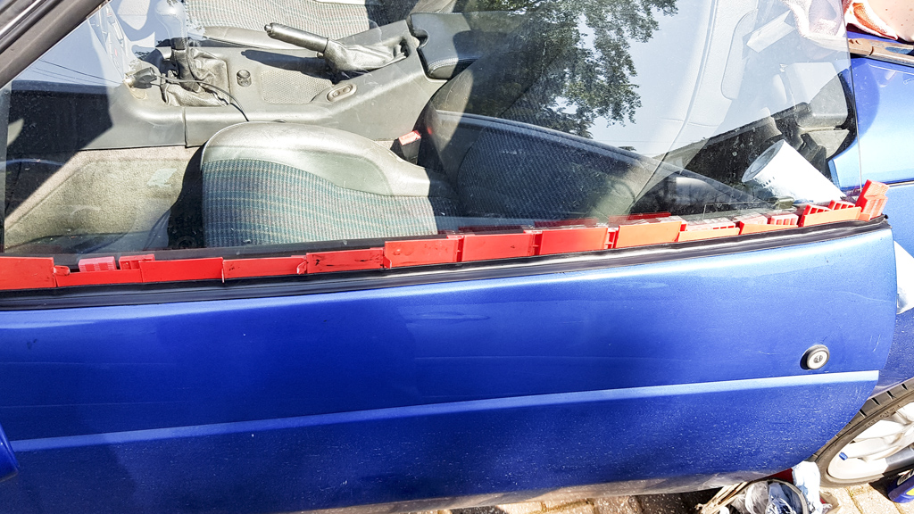

Used Sikaflex along the non-flocked side of the new seal and then put it in place and retained it with some plastic 'dividers' and wedges to force it to bond to the metal strip in the vertical plane..
(This is the bit you may have to improvise... being an engineer I never throw anything away, much to the annoyance of my wife - "that rubbish is my raw material". Small plastic sheets are dividers from 'organiser boxes' and the wedges are from timber floor panels. Wedges are also very useful to align headlamp pods when refitting.)

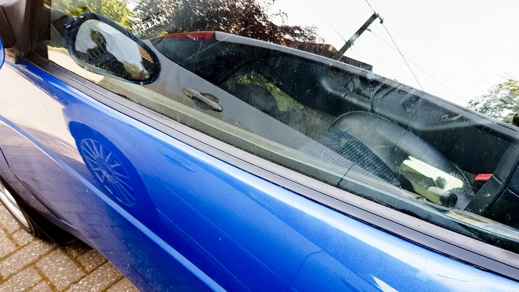

Only took 30 minutes but I left it for a while to have a cup of tea and let the Sikaflex cure .... and this is what it looked like afterwards ..

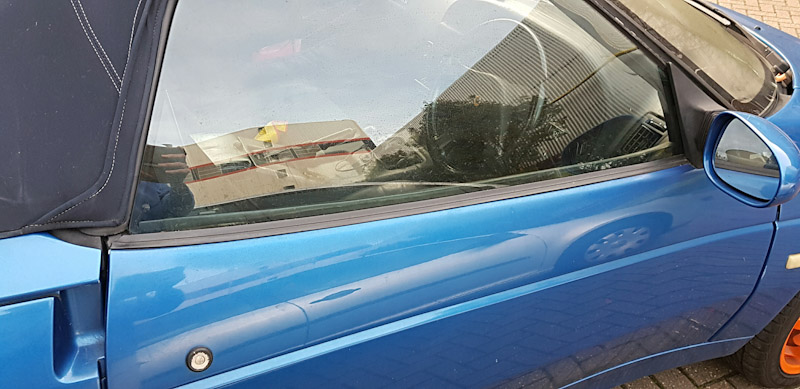

So pleased with the look, I did the driver's side even quicker using the same procedure. Second one is always easier... :lol:

No, windows are fine. Sikaflex can be cleaned off with wipes and Wyns Carb Cleaner until it cures, then nothing will shift it.
Was wearing 'forecourt diesel gloves' but Carb Cleaner ate them so I'm an honorary member of the Black Hand gang..
Tried Carb Cleaner, Swarfega , meths, white spirit, petrol ... a razor blade is the only thing that gets it off, with a layer of skin .. :lol:

Just an update to say I was just washing my Elan to remove the pigeon sh1t and noticed my 'quick fix window seals' that I did nearly 2 years ago, just before Castle Combe 2018, are still looking like I just did them.
If it's only the weatherstrip you need to replace a tube of black Sikaflex and 2 x 1m length of Woolies Window Weatherstrip (£7 each) is all you'll need, no pulling the door apart nor awkward screws to remove ..
Even if I was pulling the door apart for butterfly replacement etc I'd still do the weatherstrip replacement by this method .. so easy and it's lasting !
