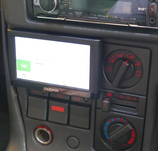

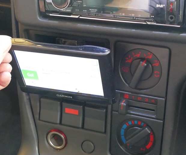

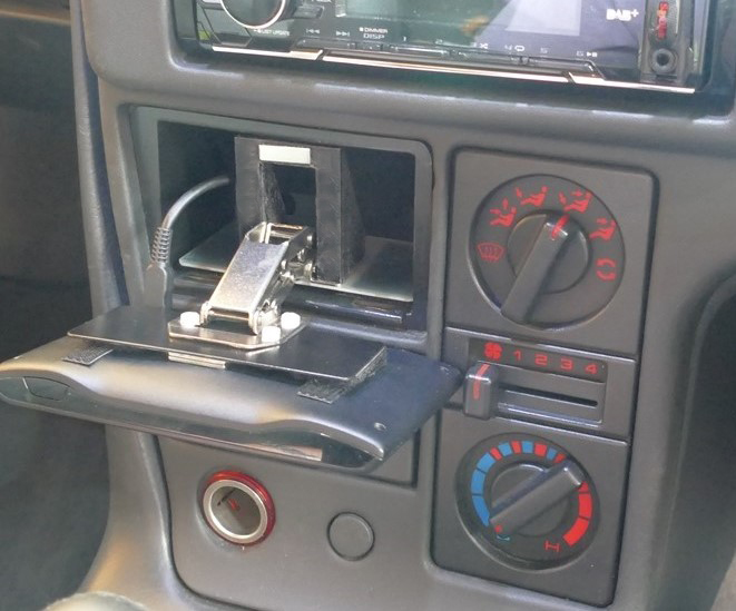

A few pictures showing the fit of a Sat Nav in the Ash tray slot. Constructed from a B & Q (flat pack cantilever type) hinge with its overcenter spring removed, mounted with 1mm fibreglass plates which attach to the ashtray cavity and back of the sat nav with Velcro. A 3D printed support for a magnet firmly holds the assembly shut in place of the original hinge spring which was a bit too strong. The only permanent mod to the ashtray cavity is a drilled hole to pass the usb cable through. Keeps the sat nav as close to the dash as possible, just out of the way of gear changes. The hinge action allows the power button on the top edge to be accessed. Can easily be removed via the velcro and the ashtray refitted whenever necessary. Done a fair few miles now - Castle Combe and Spain, with nothing causing it to fall open, the hinge holds itself back when vertical, bolstered by the magnets.

Nice job my man
Ive got a flip up but cant get new maps so not ideal.
That looks a very neat option.

Nice lateral thinking and use of the cabinet hinge. Looks like you’ve got a similar Garmin to mine, but I just used the standard mount which works well as shown here.
Something I found worthwhile was getting a non-reflective film for the screen - helps immensely on sunny days
I need to get round to drilling a hole for the power cable!
