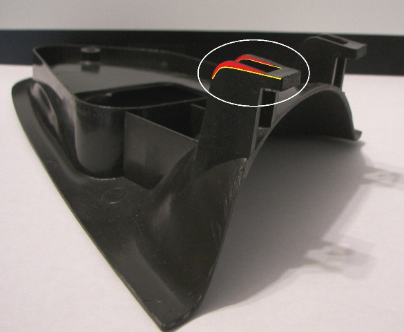

Postby WienLot » Tue 21.08.2012, 21:30
Found mine when coming back from holidays. they look absolutely great. Simply had to adjust a little bit one of them to allow fitting (right hand door). However shouldn't blame the escutcheons, it certainly reflects that our cars are hand made !
A huge Thank you again to Wayne and John :clap: :clap: :clap: and to anyone involved as well (and for everyone outstanding discipline and reliability... Very impressive for a recent member like me :clap: )
A couple of photos to show change done:
there was noy enough room between the door external panel and the door internal panel
in red, part I had to 'erase' (only on one showned)
the perfect fit

Postby wayne » Wed 22.08.2012, 23:39
WienLot wrote:Found mine when coming back from holidays. they look absolutely great. Simply had to adjust a little bit one of them to allow fitting (right hand door). However shouldn't blame the escutcheons, it certainly reflects that our cars are hand made !
Thank you for the information WienLot. I'm pleased that you have found a fix to the problem of your part not fitting correctly. Hopefully this will work out for other people that are having the same problem. Sorry that I didn't pick up on the problem earlier :(
I'm on "vacation"?? in the Uk at the moment and have been kind of busy with other problems. Have not been keeping up with things on here recently.
My apologies if the part needs to be modified to fit correctly. Hopefully following weinLot's pics if any one is having problems I hope this will fix it.
