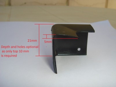

I think 3D printing could be an affordable option if the original parts were scanned and uploaded to somewhere like shapeways . Could be a good long term option if someone can scan them and create a STP file. But Looking at the mirror pivot pins I had made the texture is kind of rough.
I think Vac forming would produce a much better part. Especially if it duplicated the original part and not the couch shaped replacement that looks like it was injection moulded.
I wonder if it would be possible to vac form 4 of the corners together in a square and then cut them out?
John. I've found the pics with dimensions I made of the original parts. Maybe they could give your guy some idea until either of us find our originals that we stored somewhere safe :bonk:
I'll have a search over my days off to see if I can find the parts I have here.

The one small detail that's not showing in the pic of the original posted by Wayne is that there is s very slight lip on the original on the vertical sides (the parts that slide into the gap and not visible from the "top"). I have one original corner pulled from my car when I replaced both sides with the less than ideal replacement part - the one described here that requires you to cut them out yourself from a single piece that looks like a couch.
Any use?
