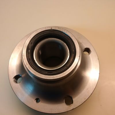

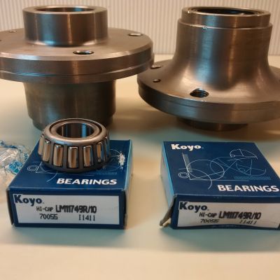

Postby ccb056 » Wed 14.10.2015, 23:03
Hubs arrived today via UPS, very securely packaged.
Thought I'd throw in some photos since there aren't any in this thread:
Couple of questions:
What is the part number of the inner tapered roller bearing?
What is the part number of the outer tapered roller bearing?
Are these identical to the ones used with the OEM system (EG Timken SET1 and SET8)?
What is the part number of the grease seal?
Since these are tapered roller bearings, and not sealed bearings, they need to be packed with grease, correct? Any recommended grease to use?

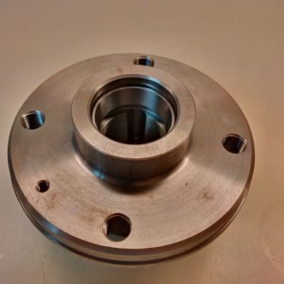

Postby ccb056 » Thu 28.04.2016, 23:01
Taking a closer look at these hubs now. I can confirm the Timken SET1 and SET8 should work. Still looking into the seal.
It appears that one of them was overbored .001" to .002" resulting in a loose bearing race.
Anyone else have a similar problem?
Jeemy, do you have a spare hub you could send my way?

Postby algirdas » Thu 28.04.2016, 23:23
Dear CCB056:
If its only a thou or two, have you considered loctite red? I have done sillier things in my life and gotten away with it.

Postby lotusflasherman » Thu 28.04.2016, 23:57
algirdas wrote:Dear CCB056:
Sincerely,
Algirdas
No, No and again NO.. Wrong product :poke: . Loctite make 660 Quick Metal to fit bearings in slightly oversize housing. Made for the job and works a treat.
Technical Data Sheet here ...www.loctite.sg/sea/content_data/93755_Loctite_660_Quick_Metal_Retaining_Compound.pdf
Says it will fix up to a 20 thou gap
Re: Custom Rear Hubs - Run 2
Postby ccb056 » Fri 29.04.2016, 00:25
While I'd be receptive to using products like this on old and worn equipment, these hubs are brand new, and in my opinion should have been fabricated to better tolerances than this.
I'd rather replace the hub with a proper one, than use loctite.
