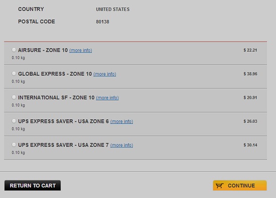

Thanks! I too wouldn't choose perforated leather for anything your hands are on because it's bound to get clogged with oil and lotion and anything else, but it does match the steering wheel and that's the look I'm going for. I owe you a beer.
BTW - did you pay $20 to ship a $3 sticker? That hurts just contemplating it.

I thought it was a bit less than that, but yeah, I did. Felt stupid doing it. They could just stick it in an envelope and put a regular stamp on it.

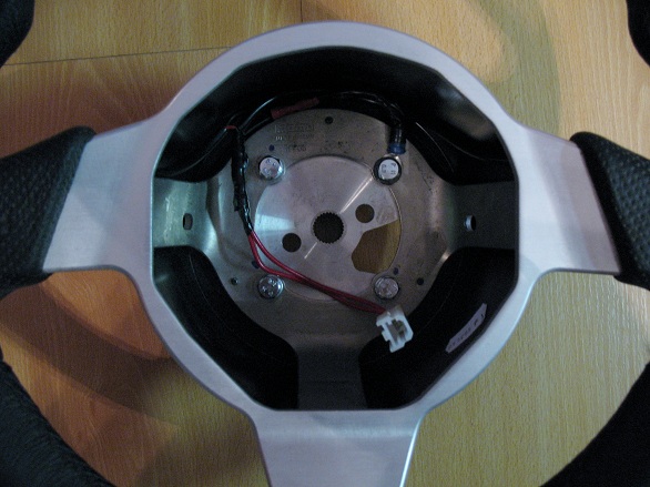

Well nobody has accused me of being too prompt, but I'm ready to finally install the Elise steering wheel with B*b's hub adapter. I need to get the correct Vauxhall airbag ring so I'd love some help tracking the correct one down.
With some clever searching I found these two on eBay, thoughts?
http://www.ebay.com/itm/VAUXHALL-AGILA- ... 1438.l2649
http://www.ebay.com/itm/VAUXHALL-OPEL-C ... 1438.l2649
If there's a better choice I'm all ears. Thanks!!

Postby Elanlover » Sun 17.09.2017, 14:20
Not sure if those are the ones. Let me have a look and see what I can find....
Re: Elise Airbag Steering Wheel Hub Adaptor
Postby Elanlover » Sun 17.09.2017, 14:31
Okie Dokie.
Looks like either of those will work. What you're looking for is the airbag plug which you'll cut off and splice into the existing contact ring. Some pics below.
