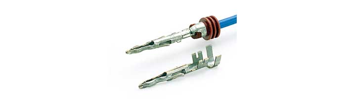

A possible compromise option if anyone's interested, might be to just buy pins?
(5.69 KiB) Downloaded 16 times
Then pull the plug housing off your old fan, and reuse?
Best price so-far is £30 for 100xSeals and 100xPins
opinions...?

I'm pretty sure they are AMP Superseal connectors - very similar to the Delphi Weatherpack, but needless to say - not compatible :(

That's not bad - as for gender, it's a little wierd - It looks like a female housing, but it has pins...
This might help:
We need 18-20 gauge.
Having pulled one apart, it would make excellent economic sense to re-use the housing, and just buy pins - 100 with seals would be good (and a smaller packet to post...)

the vendor told me "Just so you know, the male housings use the female pins and the female housings use the male pins", so that looks spot on. Any idea what gauge the pins are?

Gordon wrote:We need 18-20 gauge.

I've got a quote of $48 USD for 100 pins & seals, or $28 USD for 50 pins & Seals... (including post to the UK)...

My quote's a little bit more - $54. Thought I'd post it in full as it looks like someone else on the forum may be asking as well, and Bill seems to be a very helpful guy:-
"I think there are two people asking us about these items. We have
another person form the US asking for the same connectors, in about
the same quantity. You may want to be sure that two people are not
buying the same things. the price of the pins and the seals is $0.20
each. If you want 100 pins and 100 seals, that would be $40 for the
parts plus $14 for Priority Mail shipping.

We could of course order 100 pins and seals, so that they can all have the right pins on them, and say 10 new covers for those who don't want to DIY?
when the non-diy'rs have had thier old fans removed (complete with plugs), the plugs could be passed on to the next non diy'r?
we could of course go the whole hog, and just buy 50 plugs and 100 pins - it is quite possible that I'm scrimping around here, and in reality saving nothing?
(That said, I've already collected everyone's money, and I dont really want to go knocking for effectivly another £5 off everyone!)
buying the plugs individually is expensive though - jurys out....

It is a fairly high current rated connection around 7A continuous load, and a pretty harsh enviroment which I guess explains the choice in connector; most of that style of waterproof connectors are a similar price - and of course putting the right plug on the fan means not having to modify the factory fitted plug on the loom...
Personally, I was quite happy to just re-use the plugs off my old fans, and solder/heatshrink them onto the new fans...
I think pins only, and re-use the old plug housings is a nice compromise (and neater), which if I had the pins to hand, I would do;
The question has come about I guess to allow the fans to be swapped without any electrical modifications, so again that would mean having to stick with the weatherpack plug...

OK, in order to simplify all this, I've bought some plugs (I already have a suitable ratchet crimp tool).
These are the proper Delphi Weatherpack plug, and will fit the sockets on the existing loom.
The original price of £60 for a pair of fans stands as is, and the fans will be shipped with bare tails for you to do with what ever takes your fancy;
For an extra £6, I'll put the correct plugs on both fans (£3 per fan) so they become a straight swapout.
