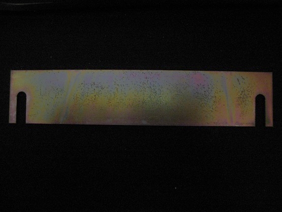

Getting closer to having the car back on the road so I'm starting on the steering wheel project again. As you may recall, the Elise wheel ,being a smaller diameter, obstructs the gauges just a bit. I was hoping to find a way to raise up the wheel without major surgery and noticed that there is a small spacer plate between where the column flanges are screwed to the body work. Its pictured below.
Its about 2.5mm (1/10 ") thick and I'm thinking (or hoping) that its removal will result in an increase of double that at the end of the steering wheel. Even raising the wheel a 1/4 inch will make a difference in the viewing angle and visibility of the gauges. Once I get everything all back together I'll let you know what the difference is.
