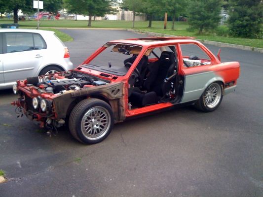

That's a good start but to REALLY add lightness I suggest this. Doesn't need struts for the hood either.

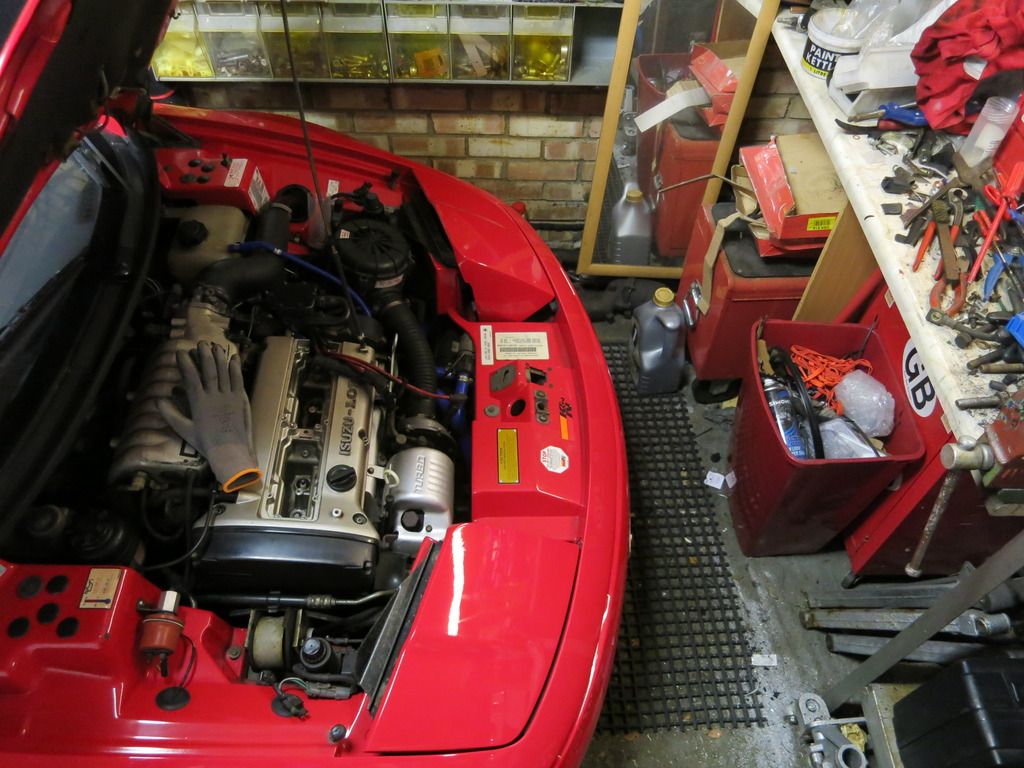

Postby Steve A » Sun 05.02.2017, 19:43
TrevorB wrote:
:( Will have to get car out of garage anyway as not enough room to do work in there, so will need some decent weather.
:roll: I know what you mean Trev, sometimes you need a good run up to get anything done :lol:
I've even added a mirror to make it seem bigger :wink:

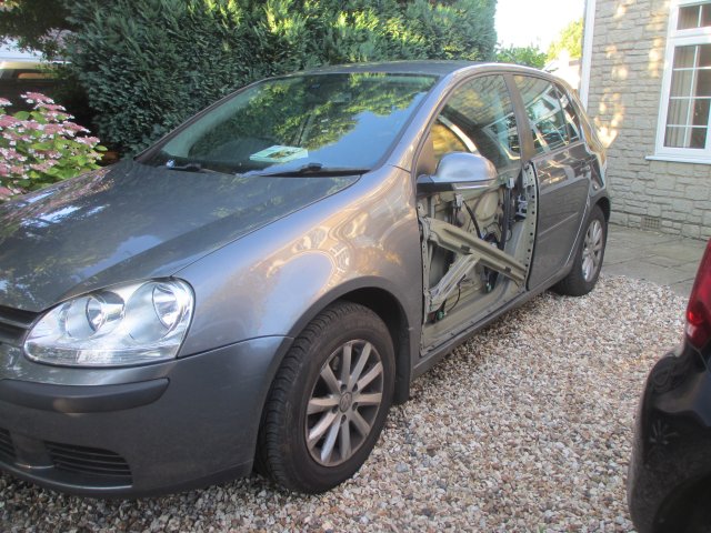

Onsie off and first venture this year out of garage. Can I find this back bracket :?: Wheel off, wheel arch liner released, couldn't find the bracket though :!:
Eventually found on a little ledge within the wheel arch. Anyway to cut a long story short because it did take 4 hours to get everything done with the
assistance of my neighbour. The new gas struts are finally on. The problems were: managing the other side back plate not dropping inside wheel arch and
getting the bonnet aligned as best we could. Still 'Merlot' is looking good and sounding nice considering she's been tucked away. Next project is to get her
looking better for the spring and summer. :wink:

The only problem I can see is that the windscreen washer pipe looks a bit below-par (other than that - it still looks excellent :D )
