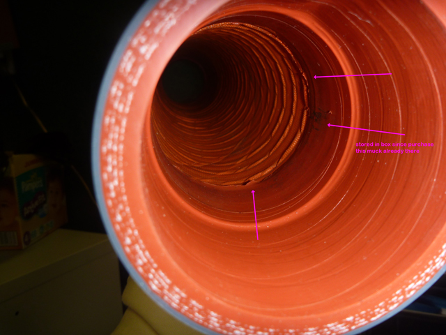

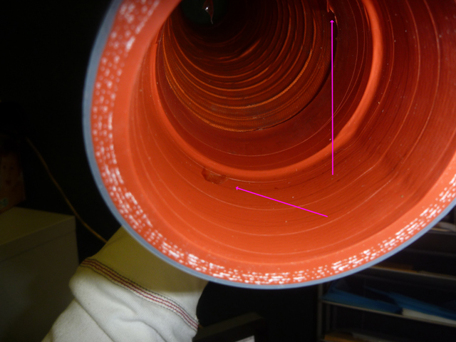

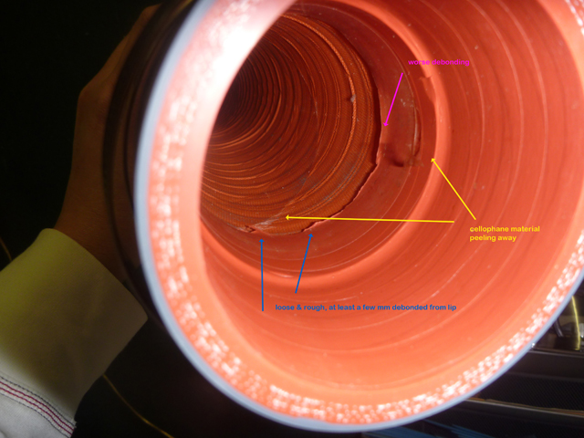

Sad to report:
Larger hose: not fully debonded like HJs, but around the circumference its loose by at least 1-2mm, and in several places more. These places are buckled up and loose, and maybe 5-10mm deep with no bond. The edges are ragged and in places its visually obvious its debonded.
Smaller hose - can only get finger in one end, the larger of the two and it feels OK. But how could I have confidence in putting this on my car?

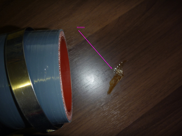

Whats worse is, when I stuck my finger in the large hose a large flake of orange cellophane type material came out. There is more in there. See pics:

Postby HJ2 » Wed 30.04.2014, 12:48
Hi Jeemy,
That does not look good. You have not been using this, right?
The last picture looks like a piece of Kapton tape, but is hard to judge from the picture. However there should be no loose parts what so ever....
