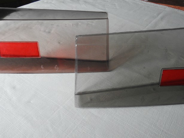

As promised am reverting back to you. I received the cover models for approval this morning (1 day late) via Chronopost. Packaging was excellent and really protected the contents properly.
Compared to the products sent out in December 2019 to 4 of our buyers (sincere apologies once again), I must say that the result (surface finish) is extremely encouraging albeit almost perfect. There are no bubbles, smears, cracks, glue marks, gouging, etc... and the aspect is truly excellent. There is just one small defect on the RH side cover where there are a few smudges on the inside but this wouldn't visible once installed. There is also a small section of the corner missing but again this would not be seen. I will however point this out and will expect our supplier to rectify this defect before any parts are produced. It's only natural that we receive a flawless product for the price paid. Otherwise I would say that I approve. I'll naturally consult another buyer who lives nearby and obtain his remarks.

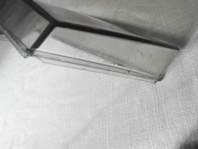

Attached are a few photos for your perusal. The defect figures in 0375a and 0376a. The others show the finish quality.
Don't hesitate to comment.

Defect visible on RH side cover smudges and small section missing

Comparison with my own rear light cover showing the tint of the new models
My cover is on the left.

I would check to see if the missing section will prevent the cover from correctly sealing on the tail light body.
The tail lights have an inherent problem with fogging up and any loss of seal might make it happen more often...
Or is it a good thing? I remember reading someone suggesting that the solution was drilling holes to allow it to breathe.

This is looking much nicer like this. I don't have all the skills to say if it's OK or not, but for a newbie like i am on such a topic, that's great.
- No defect visible to me (scratch, non consistent tint, not compliant shape...)
- Tint seems to be very similar, it seems like the red/grey difference is due to the lighting that can not be the same for both parts on the same picture (probably difficult to have a good shot with a camera as the parts are large)
- if you confirm you can mount and adjust it on your M100 just as you would do with your original cover, and it sticks to its place as it should, then, i guess all points are good in my opinion.

David - to me it looks like someone has picked it up in the corner using their thumb and finger and it has just snapped off for some reason ?? If you think this is a possibility, try grabbing the unbroken one in the corner by thumb and forefinger and wave it around and see what happens :shock:
Another explanation may be that the package has had a bump in transit causing a fracture ?? But you did say the package arrived well packed
I wouldn't imagine your manufacturing company would send them off for inspection like this. Why would they ?

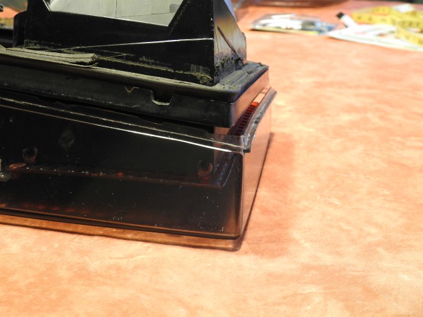

LH side one ok. Not fragile at all. No trace of missing section in the packaging. I'll have to await his return on Tuesday to ask why this section is broken and why he sent it off like this, if indeed this is the case.
For the moment though, can't manage to mount the covers on the light support. There would appear to be a problem. My own covers fit on no bother. Will advise further on Tuesday.
When you say you can't manage to mount on the covers, are they "too tight" to be fitted in place ? I wasn't even thinking that they couldn't fit as it's supposed to be a copy of the original part. That said and from the email I've sent you, I think the overall quality seems to be good this time but like Rambo said, I don't understand why they would have sent parts for approval that aren't perfect and with an obvious missing piece. I hope that the production run will remain on a good quality for the whole time and that they won't let go some that could have defects.

Email sent off to you in reply. I'll have explanations by Tuesday. Meanwhile, there would appear to be a "dimensional" problem. The models do not fit into the plastic backing support. Would appear to be too long or else the angle of the curved section is wrong. Can't understand as my originals were used as a model to manufacture the moulds. Again, I'll have answers and explanations on Tuesday.
Just when things were starting to look good!!!!

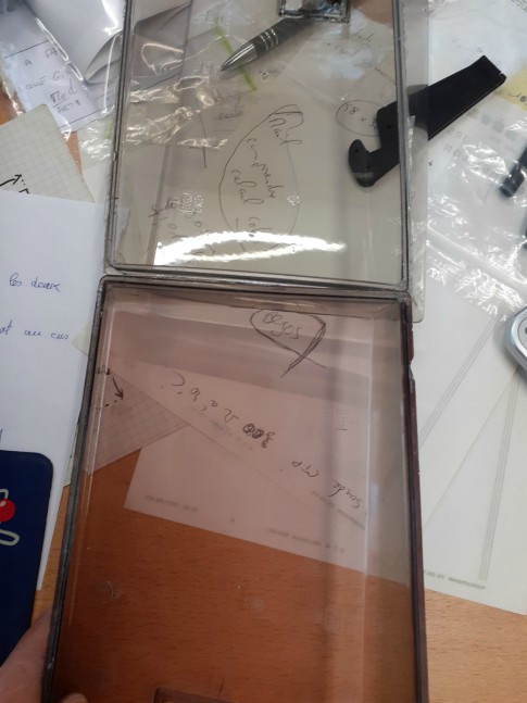

Our supplier contacted me this morning as agreed. Photos had been sent to him by me on Sunday showing the "dimensional" (hence mounting) problem (see photos attached).
The explanation for this is that the models sent to me for approval correspond to Alpine covers which are slightly longer and not identical dimension-wise. Our supplier - like myself - was unaware of this. Indeed, the covers (my ones) I handed over to him when I went down to Dax in January were finally not used as a model (too many scratches and imperfections) and he ended up using Alpine ones, hence the discrepancy in dimensions. He thought they were identical and produced the pre-production models sent to me for approval. This explains why I was unable to mount them on my cover supports. (See attached photos).
In view of this, we are now faced with a problem. In order to progress towards final production, we require a pair of M100 covers in very good condition (absolute minimum amount of scratches or imperfections). These will be used to produce the moulds but will naturally be useless afterwards since they will be painted in order to obtain the finish quality visible on the models sent to me and with which a large number of you were very satisfied. Naturally, you will receive a new pair in replacement (plus the ones you've ordered).
Are any of you willing to sacrifice a pair of rear light covers so that we can finally move towards final production? On receipt, the moulds would be prepared and the pre-production models produced. This would take around two to three weeks after receipt of the covers which brings us to around the 3rd week/end of March 2020. I could sacrifice a RH cover from my other Elan (LH one broken) but we would need a LH one to complete the pair. Please advise ASAP.
Rambo (and others who pointed out the small broken off section : Since it was not visible once mounted, he decided to send it all the same (indeed the main issue was to show the near perfect surface finish). He of course assured me this morning that this type of flaw/defect would not be present on the production parts. Assurance was also given to me that all produced parts would be identical throughout production.
Cover models received showing the "dimensional" problem 0441 0432 0425

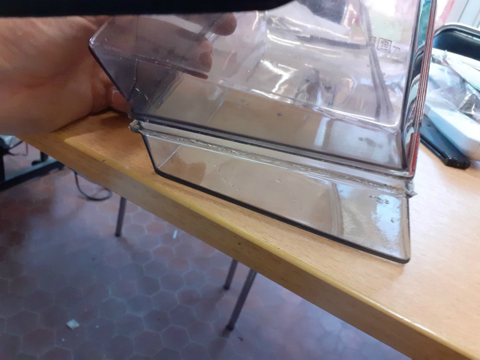

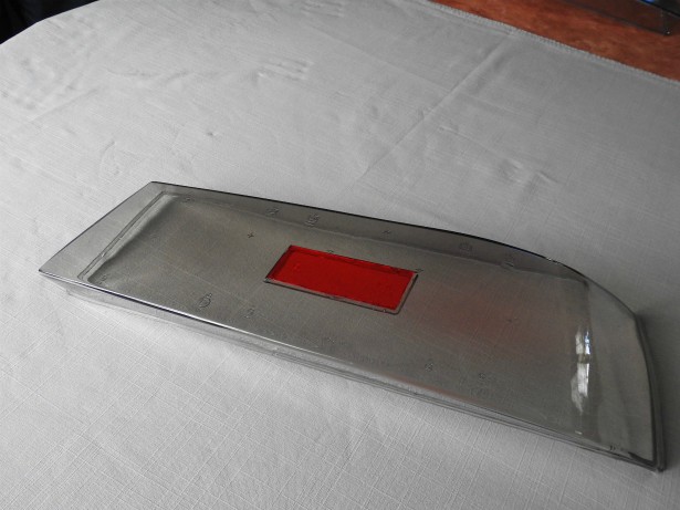

Attached photos of the newly produced Alpine covers (sent to me for approval and which differ from our M100 covers) showing the identical dimensions with the original Alpine model sent for producing the mould.
Newly produced clearer cover against original Alpine one showing same dimensions
Other photo showing same dimensions
Photo of original Alpine cover prepared for producing the mould
These photos clearly show that the dimensions of the Alpine covers are not identical to those of our M100s
