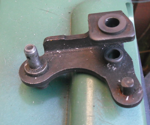

Postby bobbrown » Mon 17.09.2012, 22:50
dapinky wrote:....personally, i don't find that the standard gearchange is at all bad, especially if the bushes on the gearstick linkages are nice and tight (I changed mine for new ones).
I tend to agree with the bit about the bushes and as far as the short shift is concerned it is a bit of horses for courses and the whole thing is reversible.
Also mine is adjustable on the fore aft lever e.g. 1st to 2nd so you can have a short throw, a shorter throw and an even shorter throw the middle option being the same as Dave's. On my car it is set on the shortest setting as it should bring out any problems with my cables if indeed there are any as it should have increased the loading on the cables, nothing to report on that score to date.
As a point of interest the bushes I use on the bell crank for the crossgate also fit the original and are a much more suportive than the originals and are a press fit in to the folded metal bell crank.
Not sure how they compare price wise to the OEM ones as SJ's site seems to be down at present but the bushes I use are £2.00 + p&p the pair and are made of Iglidur® M250.
