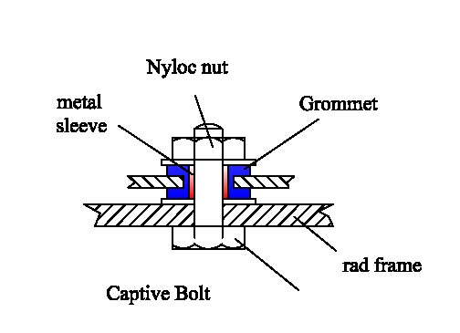

Hi Gordon,
When you say "I'm just trying to find grommets for a sensible price" how are you thinking of fitting these fans?
My idea would be to use a grommet as you suggest but with a center metal sleeve and a washer on the outside.
http://www.grommets.co.uk ????
If you need any help with any of this, like a center metal sleeve please feel free to email me direct and I can send you a picture of what I have in mind.
edit
fan fixing.jpg (14.59 KiB) Viewed 9194 times
something like that
Bob

I'm only looking at replacing like for like, so no center sleave, and still using a plain washer, then a nylock nut. Just to keep the vibration down a little. Think I've got something lined up, just waiting for price.

Postby bobbrown » Mon 01.12.2008, 17:14
Sy V you could well be half right as I think they are on captive bolts.
Like this, but may be with out the sleeve, I do not know as I have yet to take them off

Postby Gordon » Mon 01.12.2008, 17:31
Mine are welded M5 studs, which looking at the parts manual, is correct.
4 along the lower support frame, and the other 4 along the upper crossmember.
The studs are only paritally threaded aswell - there were no sleeves on mine, and I have no reason to think the fans have ever been off...

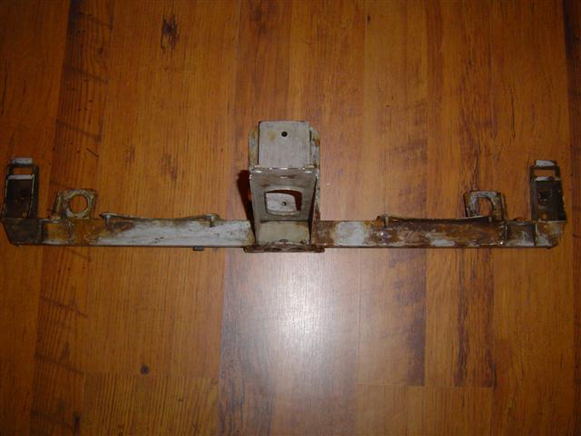

I suspect my rad support frame is in pretty typical condition for a 1991 UK model:

Postby dapinky » Tue 02.12.2008, 01:32
Gordon wrote:I suspect my rad support frame is in pretty typical condition for a 1991 UK model:
Nope - it's far better than mine was :shock:
Half an hour with a sandblaster and a bit of a squirt of etch primer and satin black hamerite had it good as new!

Postby Specky » Tue 02.12.2008, 14:34
mines worse too...
not much rust on mine thou...
But it's bent..... and one of the Y-brackets is really bent.... evidence of one of the front end crashes... :cry:

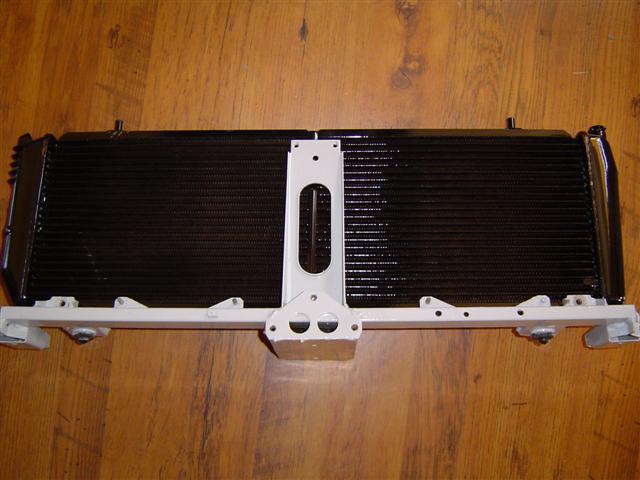

Postby Monty » Tue 02.12.2008, 15:37
Mine was not as bad as that one
Over a year ago
Cleaned & Painted
