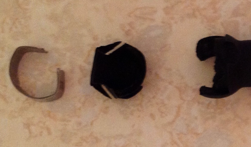

Postby epipete » Fri 04.01.2013, 20:52
Thanks Guys, but it's all just become rather academic. :banghead:
Rather a waste of many quids I fear :smt076 :smt076 :smt076 :smt076 :smt076 :smt076
Broken piston!

If you installed the kit according to the pics I posted when it was originally installed (and similar to m100sandra's pics) they should not foul on themselves or any body work. Of course, lining up the hood/bonnet afterwards is a key step. But, since you've discovered a broken end on one strut I'd guess that's your problem. You can contact the supplier to see what they can do for you. It may be possible to replace just the end fitting although they tend to be put on with some form or adhesive for obvious reasons.

You can get end fittings for the struts here http://www.strutsdirect.co.uk/component ... -range.php

Postby epipete » Sat 05.01.2013, 00:29
Thanks Sandra, they seem to offer a cost effective solution.
