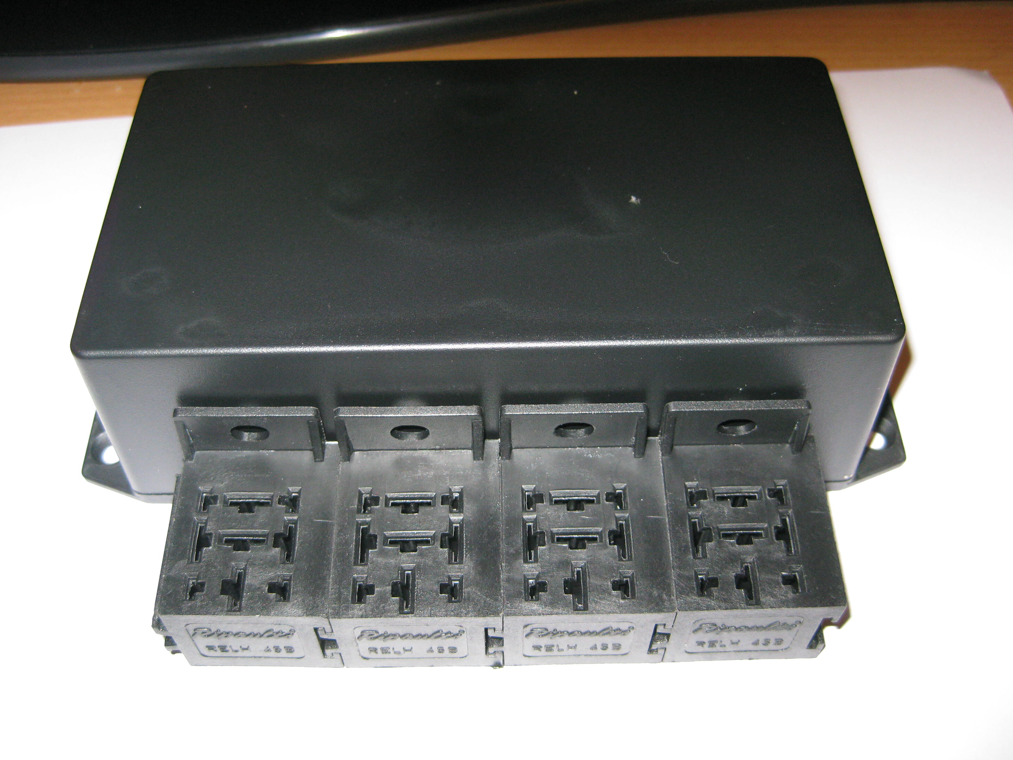

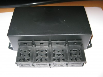

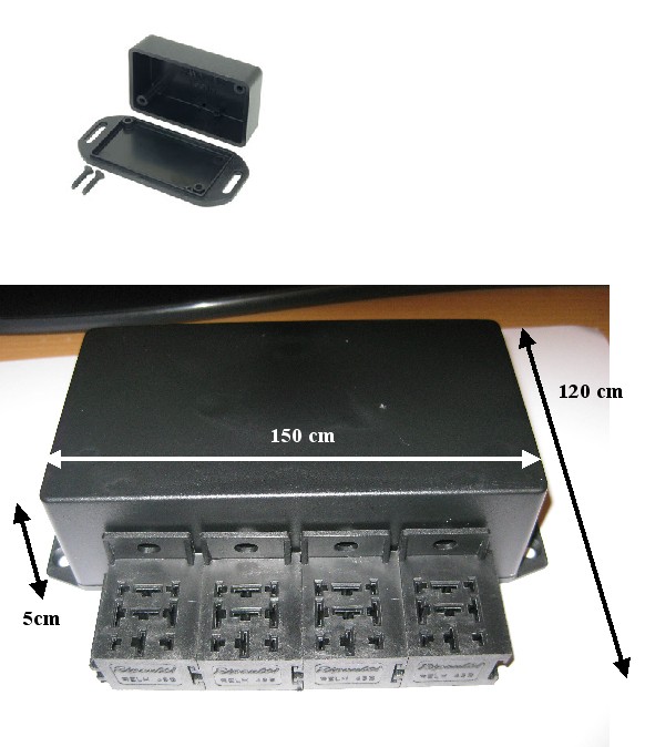

Below are some pics of what's likely to be the module enclosure. The prototype should be ready for testing in a week or so.
Re: One touch window up/down control
Postby lotos » Thu 06.03.2014, 16:55
I'm going to guess you mean MM not CM in that last pic. 150 cm is like 5 feet long :mrgreen:

Postby Elanlover » Thu 06.03.2014, 17:10
Yes, pretty sure that's the case.
Unless I forgot to mention the custom Elan trailer that comes with this to haul the module. :-D

lotos wrote:I'm going to guess you mean MM not CM in that last pic. 150 cm is like 5 feet long :mrgreen:
probably 5cm tall tho'

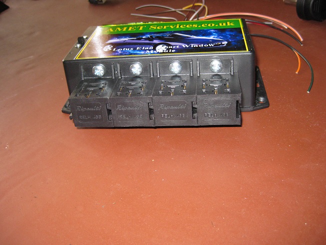

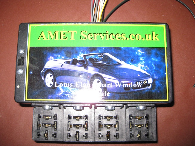

Postby Elanlover » Mon 10.03.2014, 13:22

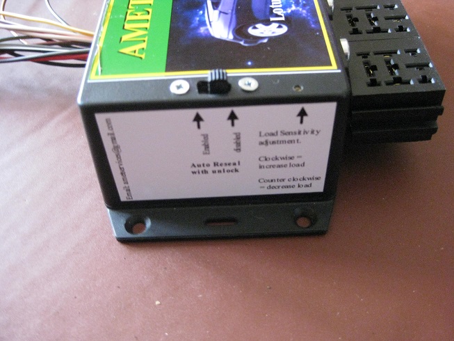

The prototype is just about ready and it should be towards the end of the week when it gets installed and tested. Pics below of the "Lotus Elan Smart Window Module".

Some modifications were required to get the load sensing to work satisfactorily, make the module wake up upon current sensing, etc. This is a complicated project with a lot of testing and reworking required but it seems all of the major issues have been resolved, A revised prototype will hopefully be tested next week.

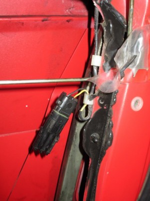

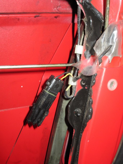

Postby GeoffSmith » Thu 01.05.2014, 15:21
Not sure if you're still using the door latch switch Blair but as I suspected, it isn't connected in the S2:
Postby Elanlover » Thu 01.05.2014, 16:37
Thanks Geoff, I'll pass that along. I hope to be back in touch with the designer next week.
