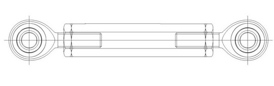

Postby bobbrown » Fri 26.03.2010, 11:52
drop link.jpg (15.74 KiB) Viewed 8414 times
in stainless steel as the loads are not very high and the rod ends are rated at over 1127kg
Both front and rear are the same so 4 required /car, cost £25.00 each complete with new nuts and bolts so a full set is £100.00

Postby bobbrown » Tue 30.03.2010, 23:19
I have enough parts to make 20 axle sets so as far as the list goes then there are 3 axle sets left assuming BFG in the BRG wants 4.
I can make more but would need to get the rod ends from the USA as the UK supplier is now out of stock I had the lot.
I am hoping to get these made before Malvern so if you are going and want to collect them let me know.

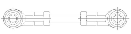

Postby bobbrown » Thu 01.04.2010, 12:05
On to plan B
I have tried to get more of the female rod ends at the right sort of price but have failed miserably so I am reverting back to the original plan and will supply the links with male ends and center section to suit.
The male ends I can get in resonable quantitys so supply is not a problem although not as simple to make the joining piece
So the first batch will have a 10mm rod and the second batch a 17mm hex bar with a 8.5mm hole down the center
first batch
second batch
