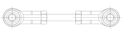

in stainless steel as the loads are not very high and the rod ends are rated at over 1127kg
Both front and rear are the same so 4 required /car, cost £25.00 each complete with new nuts and bolts so a full set is £100.00

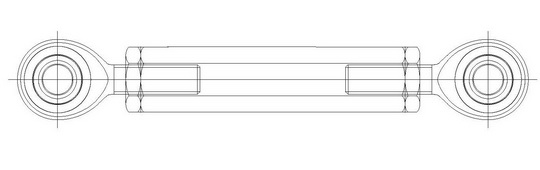

On to plan B
I have tried to get more of the female rod ends at the right sort of price but have failed miserably so I am reverting back to the original plan and will supply the links with male ends and center section to suit.
The male ends I can get in resonable quantitys so supply is not a problem although not as simple to make the joining piece
So the first batch will have a 10mm rod and the second batch a 17mm hex bar with a 8.5mm hole down the center
