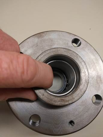

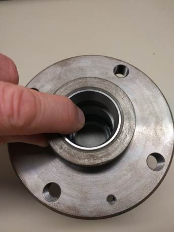

I was a participant in Jamie's (jeemy) second "Rear Hub Group Buy". I ordered a pair of hubs WITH the bearings included and installed.
One of the wheel hubs I received had an oversized bearing race bore which enabled the bearing race to slide in and out as well as spin in the bore with just my index finger gently pushing on it.
The bearing races are supposed to be an INTERFERENCE FIT and should require a fair amount of pressure to fit them. Some people use a press while others use a drift and a hammer.
Jamie was contacted and was accommodating in sending me a replacement for the defective hub.
Unfortunately, the replacement took five months to reach me.
When I finally received the replacement hub, the replacement hub was also defective with an oversized outer bearing race bore.
Please, see the two photos below of the second replacement hub, showing the race in the outer position and in the inner position with only finger pressure doing the movement.
Please see my previous posts regarding the first hub: viewtopic.php?f=85&t=22935&p=319019#p319019
Some technical details:
Stock hub/disc outer bearing bore: 1.569 inches
Replacement hub outer bearing bore: 1.570 inches
Timken S2 bearing race outside diameter: 1.570 inches
SKF bearing race outside diameter: 1.570 inches
Real interference fit of the race into the hub: 0.000 (NONE!)
Using a caliper for measurements limits accuracy to 0.001 inches.
The interference fit should be .001 inches based on the standard of 0.0005 inches per inch of race diameter.
If the race is allowed to operate in this manner, the race can and (most likely) will spin in the hub rather than the bearing spinning in the race, generating heat beyond its design limit, degrading the bearing integrity to its failure point. Once the bearing fails, the "hub to stub axle connection" will be destroyed (the hub will wobble severely), with potentially fatal consequences even at moderate driving speeds.
I STRONGLY SUGGEST that everyone that got a set of hubs from this Group Buy should carefully examine their hubs, bearings and races.
Please make sure that the inner races are a tight press fit into the hub and the bearings have not overheated.

The manufacturer appears to be able to produce both "good" hubs and "bad" hubs, so their manufacturing process should be questioned especially how it is programmed and how well it is maintained. A CNC machine should produce hundreds of identical parts all day long with not a .00001" deviation between any of them.
Regarding your statement: "- a locking compound was used in run 1, and on assembly, they forgot to use the compound" is ludicrous. There is NO WAY a bearing race should EVER be "glued" into place. The bearing manufacturers ALL provide the proper interference fit required to keep the race statically in place so it doesn't start to sympathetically rotate with the bearing. We use bearings with races because the are EXTREMELY HARD, RESISTANT TO DIMENSION VARIATION DUE TO THE HEAT GENERATED DURING ROTATION and the reason the races are fitted is so the DON'T ROTATE inside the cast iron hub which, when it get hot, expands.
The potential of bearing failure due to excessive heat or increasing gap between the bearing and race goes up dramatically when a bearing race "spins". If a wheel bearing "fails" the hub is no longer centered on the stub axle and will wobble dramatically. The only thing that would keep the wheel/hub assembly from coming off the car is the brake caliper and the excess forces put on it would seriously diminish the brake pedal pressure as a lot of the stroke would be wasted just trying to get the pads back in line with the now flailing disc. So you have a car that is wobbling/bouncing down the road and almost no brakes. That is a terrifying position to be in. PLEASE DO NOT COME BACK AND SUGGEST EVERYONE GLUE THEIR RACES INTO THE MISS-MACHINED HUBS. I would expect someone to take legal action to that kind of solution. Hard to do it from the US, but the UK has engineering standards that would seriously frown on a remedial repair for a serious tolerance issue in manufacturing.
I know this probably seems like a direct assault on YOU, Jamie and it really isn't, but since you represent the manufacturer, you are the only person that can resolve the situation safely. The only solution is to recall the hubs and replace them with hubs that meet the specification EXACTLY and CONSISTENTLY.
I grew up in the days of Drum Brakes and horrible engineering and have seen more than a few cars "hauled in" with a wheel missing because a bearing failed and the wheel, tire and hub went a different direction down the road. I have also experienced having a rear tire go flat while doing fast laps on the NASCAR banking at Charlotte Motor Speedway. The flapping carcass produced an effect similar to a bearing failure and it was all I could do to keep the car off the outside wall since I had lost the connection to the race surface due to the tire not running true. It is truly a scary place to be in.
Meanwhile, Eddy and Christian have been running their car on the original Lotus hub/disc units for well over a year while waiting for a solution. What is the chance that you could send them the "good" hub you found so they can finally install the upgrade they paid for last year?
Re: IMPORTANT SAFETY NOTICE - GROUP BUY REAR HUB
Postby dapinky » Sat 15.10.2016, 16:19
I have to agree with Johns' post above, and can add the following information.....
.... when Bob did the original run of hubs (or however many 'runs' there ended up to be), they were supplied as 'standard' with no bearings fitted, and he only actually provided them with the races pressed into place if people specifically requested it.
Some were supplied totally 'bare' for purchasers to source and fit their own choice of bearing (by choice, I mean by manufacturer/supplier, not dimension/specification), and with others he supplied a bearing set from his own supplier (can't remember the make/details, but they wern't cheapo Chines copies.)
The set I got were supplied with a set of bearings for me to fit - however, as I had 2 cars at that time, I used the supplied set of bearings on the red car, with OE hubs - they needed to be pressed in.
When I fitted the hubs to the blue car, I sourced a set of bearings (SKF) and they also had to be pressed in (no idea of the force used, by bench press doesn't measure force, but they didn't strike me as being anything different to fitting them in either hub or OE hub/disc units.)
There was never ANY suggestion that the fit should be anything other than a 'standard' interference fit, and NEVER was any glue used (okay, it's a specialist compound, but still glue!).
I don't know how many units/pairs he supplied, but I don't know of any which demonstrated this current issue.
I can only summise that the problem run were either made in 2 small batches, and the CNC machine was out of callibration for one of them, or their tollerances are out, or their QC is lacking.... either way, at least the one good thing to come from this is that the problem was picked up by someone who knew what they were looking at and highlighted accordingly.
As my final submission, i would suggest that the ONLY way to resolve this situation is to have the manufacturer provide replacements for ALL affected units - glue is not the answer.
The only 'safe' engineering solution, other than replacement, is to 'metal spray' and re-bore the items - but with the shipping costs, material work and machining, it isn't really a cost-effective solution - unit costs for the manufacturer should be fairly insignificant, and they need to suck it up - and quickly!
