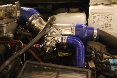

more pics and the new BOV setup
lotusgirlmarie
Goddess
Posts: 1434
Joined: Thu 14.07.2005, 07:35
Postby Paul.P » Fri 20.07.2007, 19:33
lotusgirlmarie wrote:more pics and the new BOV setup
That BOV is a superb bit of kit Marie, think i'm gonna come over there & do a closer inspection of your bits :wink:

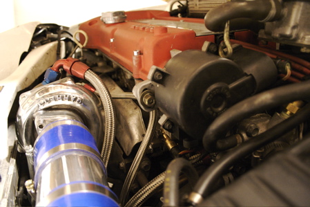

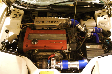

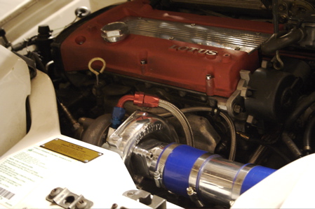

You can all start drooling now........ Over the car.... Geeezz!!! Men! How about this little upgrade....... :-D More info to come available soon.

NICE! - Looking forward to hearing how it runs. Which model turbo have you fitted?

That's a beauty. I don't think who else can get the intake pipe straighter than that. :shock: I'm sure she can breath.
New coolant tank too.
Some serious work polishing that turbo. Neat installation :smt023 :smt023 --> 2 big thumbs up from me. :-D

Postby lotusgirlmarie » Sat 21.07.2007, 12:20
It's a Garret GT2560R. The compressor housing I machined down and polished out myself. All of the pipe is mandrel bent stainless steel (downpipe) and polished aluminum for the intake. The oil and coolant lines are all Aeroquip. Currently running only 9Lbs. of boost. Houdini and I were talking about doing something like this years ago. He beat me to the punch but, I do have to admitt my whole install took me 3 days versus almost a year... Its all in the LEC family though so my hat still goes off for the inspiration.
Soon this setup will have a twin in Stripey...... Let the power begin! :-)

I will be making a third downpipe as a template for future production. If there is enough request for it I can post a list of what is needed for the conversion.
As far as the "seat of the pants" dyno goes it deffinitely feels faster. Boost comes on much earlier and it pulls al the way to redline. On my way in to work yesterday I raced a new Gallarod up to about 100MPH. he beat me off the line but I was right on him by 40 and was 1/2 a car length ahead by 100. We both still made the stop by the end of the city block.I was a bit shocked :shock: as was the guy in the 'Ghini. :oops: I think I will need to get an uprated wastegate as the one that comes with the unit is rated for 5Lbs of boost.Even with the Greddy boost controller I seem to only be able to muster 9-10Lbs. Need to figure out why.Should be fun though once it gets tuned.

I replaced mine and it cracks at 10 PSI, it is much better. The old one tended to creep open too soon, and the boost controller had trouble with accuracy as the duty cycle was getting really high in an effort to control it.
Having a higher rated actuator keeps the duty cycle lower, which is better for accurate control.
Of course, you will probably run boost levels that are much higher eventually, and most of the internal wastegates are pretty wimpy, so...

I thought it looked familiar! Same as Houdini fitted to Smaug. I can state from experience that with the proper wastegate, 16PSI is no trouble. :)
Posts: 2715
Postby lotusgirlmarie » Sun 22.07.2007, 14:35
Similar but not quite the same as the one in Smaug. I machined off almost all of the lettering and the stupid nub then polished out the housing to a mirror finish. The intake is a 3 inch inlet also mirror polished and port matched for better flow. the compressor outlet is stil the same 2" outlet that Smaug has... just mirror pollished. It does thook the dog's though....
