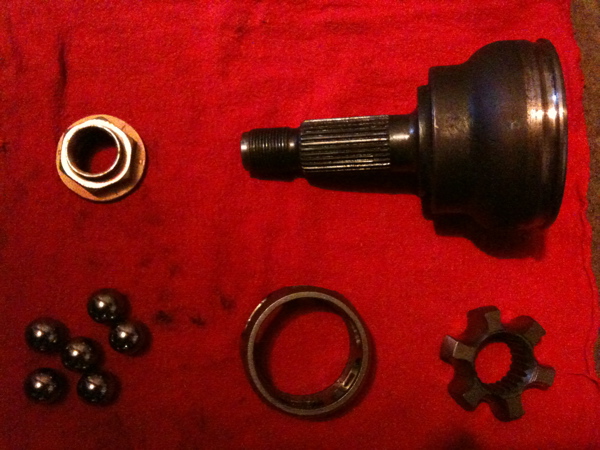

This was the good side I rebuilt. the other side was in really bad shape and cannot be repaired. The spider is damaged as is the receiver cup.
I have an email into Lotus we'll wait a few days and see what pops up. If no joy I'll seek other means. Ooooo this sucks

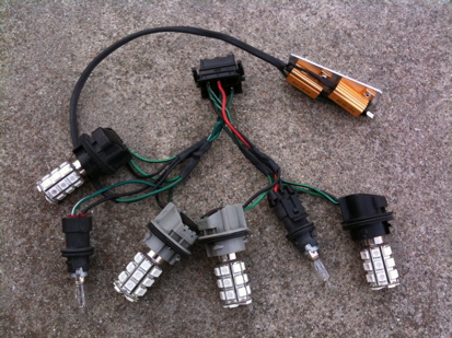

I just finished up doing the wiring for the new LED lighting for the Elise lights. Turn signals work as normal with the resistor packs I built. Crazy looking bulbs, too. They work famously though.

weird bulbs!! do you have a picture of them working?

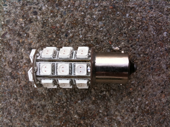

Postby lotusgirlmarie » Sun 06.06.2010, 13:31
From their website
http://www.ledlight.com/detailpopup.asp ... -light.jpg
They have really pure red colour in the lail lights and an instant on off. Very even dispersion and little to no heat. Great I sound like an advert. They are really nice though. All of my exterior lamps with the exception of the reverse lights and inner turn signal on the rear are LED now. It's really expensive to swap them all out but considerring you will never have to buy another bulb......
