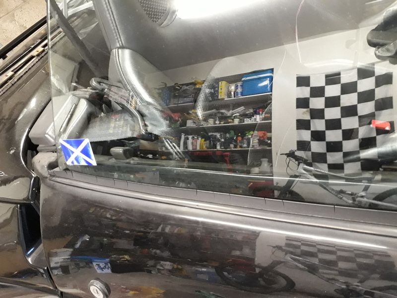

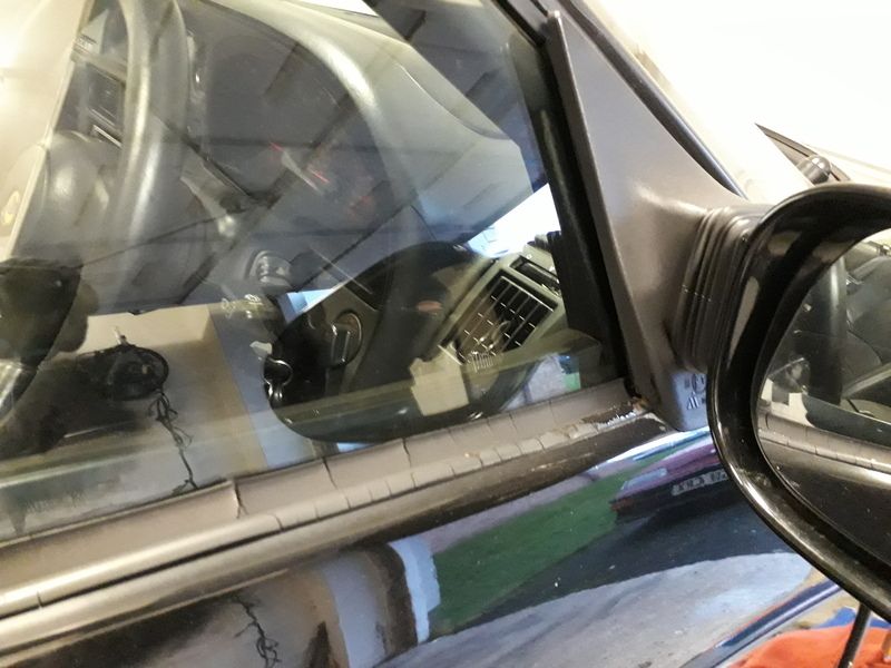

Replacement of the window weather seals were a priority as the old ones were really letting the car down:-

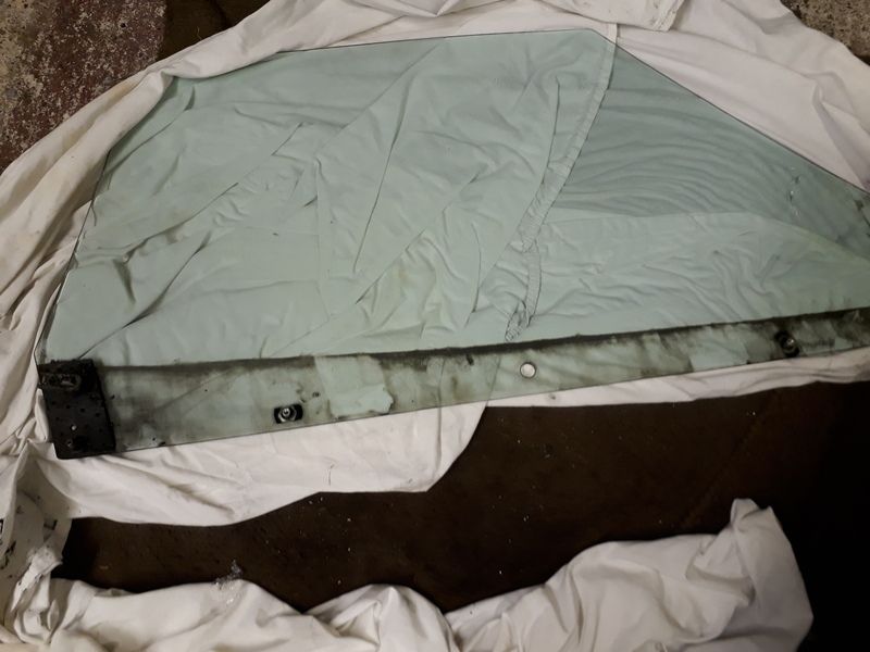

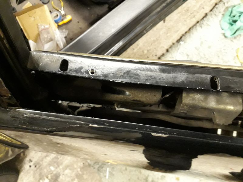

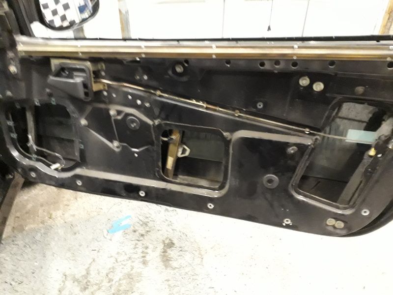

To get to the fixings for the weatherseal strips needs most of the door to be stripped down:-

Unfortunately when the door is stripped down this inevitably leads to project creep so new parts were obtained from Wayne to refurbish the window mechanism as a couple of the runners had broken and only about half of the main slider/butterfly clip on one side was remaining:-
On one side the cable had been operating off the pulley and the pulley had completely seized so had to be freed up and lubricated:-
I also found out the reason it had been operating off the pulley as the cables had snagged inside the regulator and whoever had been in before likely took the cable of the pulley to get the extra travel to allow the window to close, so the cables had to be rewound back on to the drum without snagging. As the way of these things are this was only discovered after the window assembly had been completely re-assembled so all had to come out again :roll:
