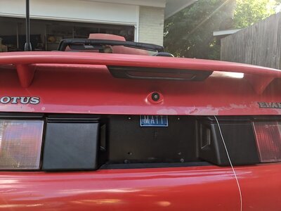

Postby TorqueHorse » Thu 25.06.2020, 06:20
Keeping on Creeping on
With the pile of parts mounting in the garage I was determined to start putting some things back on the car, so I decided to tackle the trunk.

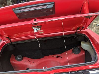

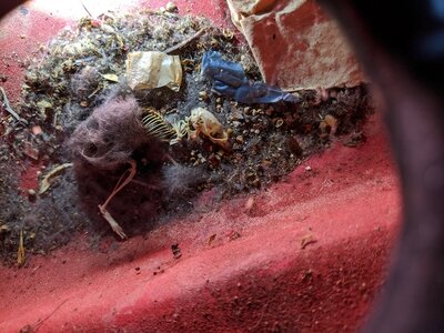

It was in a sorry, neglected state and I had even pulled the lock off the instant I had finally been able to open the trunk, months ago. I'd been nervous to put it back on and have it get stuck again, but I wanted it off the workbench, so I took a crack at it. First I just let the whole lock cylinder soak in WD40 overnight and then I could wipe a lot of gunk out of it. Then I filled it with graphite and the action seemed to work ok, on the bench at least. Then I cleaned out the trunk, scrubbing the fiberglass and I derusted and restored the spare tire mount and lugnut wrench while I was at it. It was also time to put Rosie the mouse to rest at last, may her spirit always watch over the car.
RIP Rosie the Mouse
With little Rosie taken care of (and surprised that the original spare tire was able to still hold air), I focused on the lock and how I could feel safe that it wouldn't get stuck again. I know eventually I want to put in a trunk release solenoid and button, but I have too much creep going on already so i just have a jury-rigged prototype for now. I was able to thread some string through the vent gaps and it attaches to the latch release, inside the hood.
There is a hole on the latch which looks like it is made for this and works great with a little tug on the string. Now I'm not scared of locking the keys in there or even if the lock seizes up again this is directly on the latch, so less things to go wrong. It also gives me a good idea for how I could run some airline cable with a solenoid for the electric release down the line. During this time I also had the joy of taking off the 11 screws, just to check on why one of the license plate lights wasn't working (loose bulb). While I was in there, I continued to clean and restore the trim. Very happy with the results of the Meguiars Black.
Yay, trunk cleaned, trim tidied up, and metal pieces restored/repainted.

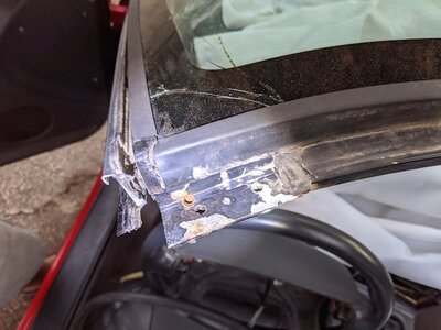

Then I thought I would be on a roll and go ahead and get the windshield glass replaced to make the front look better too. Called a glass shop and they had a piece in town, and could come by the next morning (why weren't alarm bells going off that it was too good to be true at this point?). I excitedly took apart the a-pillar seal and channel and interior trim, only to have the glass show up and be nowhere close to a fit. One of the sources has it listed that the Isuzu Impulse windshield fits as a substitute, but not this one. So that was very disappointing because I still have a cracked windshield and now there is even more crap that I've uncovered that needs to be fixed/cleaned. Some of the screws that hold the aluminum channel to the frame had completely rusted away and the biggest surprise was that the 'drain' at the edges hadn't just been clogged, but actually filled in with what looks like sikaflex. Its in both sides, so that is fun trying to dig out.
Surprisingly though, the seals came right out with no fuss or tearing, so I guess I'll have to nurse them along for a while longer, sorry Jaime ;)
