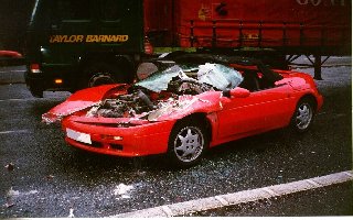

Postby Sy V » Sat 14.01.2006, 18:58
I wouldn't have thought so. I've seen two or three series of photos of Elan crashes where the so-called windscreen cage has bent (best case) or totally collapsed (worst case). Apologies to Maggie for the reminder!
