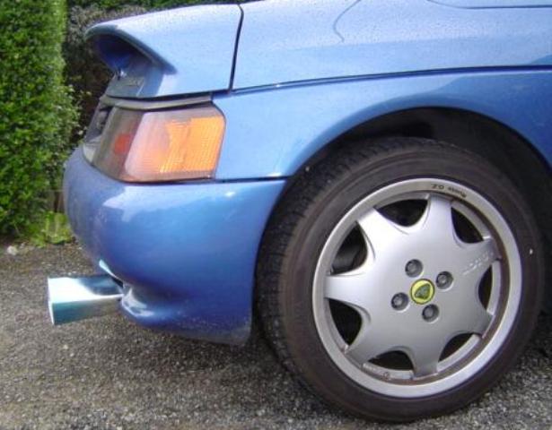

I hadn't realised it was you posting Monty, I guess I was too busy wiping the puddle up off the floor. It looks even more like an old beans tin from above.

Now that's real class. Colour co-ordinated exhaust.

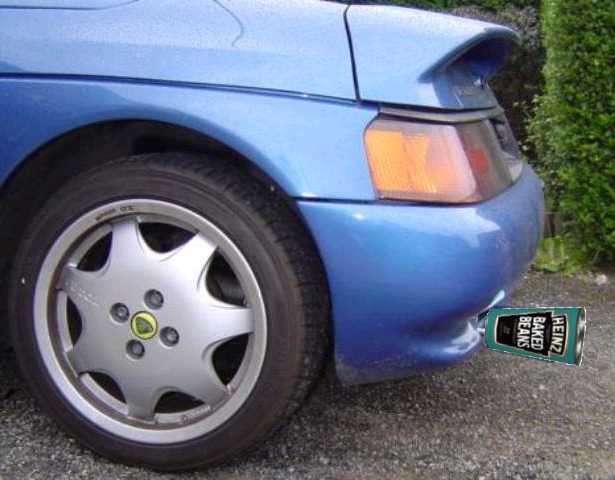

Think I might go for this one myself instead of the PECO one. Its so bad its good. At least they'll be able to re-sell it - to a ned with a Nova or Corsa
It's the best laugh I've had for ages
Mark
PS If you look very closely you can see Heinz 57 baked beans written on the side
Another use for an old Heinz baked beans can
Postby GeoffSmith » Fri 19.05.2006, 15:56
Well spotted Mark - it's even clearer from the other side! :P

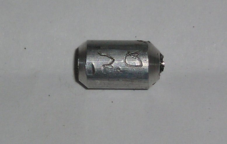

The white (ish) 'melted' bit isn't the bleed valve - Several previous posts have suggested this, however it is simply a straight joiner to by pass the BSV - cheap or what?
The 'bleed valve', or restrictor as BBR call it, is an aluminium plug with a 'calibrated' hole. See attached for a 2mm version. It should be inserted into the rubber pipe after the joiner where it re-joins the turbo intake pipe next to the dustbin. How did they get away with over £400 for it + FCD??
I suspect Dico either has none fitted or has one with a bigger hole.

2.0 mm restrictor

We suspected that the plastic part was just a joiner, this one was a T piece and one end was melted closed :shock: But there is no other bleed restrictor on pauls so it`s maximum boost, so i don`t know if that part was ever there :? Even thou Paul has been driving this for 3 years at 1.4bar with no ill effect think he`s going to fit a bleed valve for now just to turn it down a tad untill ESM comes out with his new chip and then he`ll disconect the FCD.
ps how did the pipe work fit to that restrictor? as there seems there no spout to push the pipe on to :?
