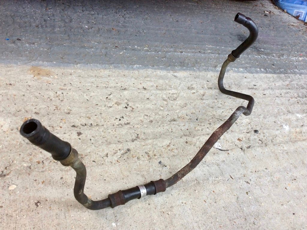

:? My power steering pipe just above the crank pulley is looking very corroded :(
Is it just a case of popping down to the local pipe squeezer to knock me up a new one,
as they did with my oil cooler pipes ?

:? Well I had a chat with the pipe man and he wasn't keen on reproducing a perfect replica of my pipework :roll:
I now have the pipe off the car and it doesn't look any prettier :(
To be fair there's quiet a lot of bending in several planes so it would take some time to perfect, and it's not like he'll have a jig to check it on.

dapinky wrote:.... eventually, i removed it, cleaned it, painted it and replaced it - and still not failed yet.
I think your right (again) Dave :agree:
Once I scraped the barnacles off the pipe it didn't look too bad, especially taking into account it's only a low pressure pipe.
I will give it a coat of rust stopper, then red oxide followed by something silver in colour :wink:

:-D Could it be the same pipework ?
It's amazing what you can achieve , half an hour getting the rust off and three coats to prevent it coming back
