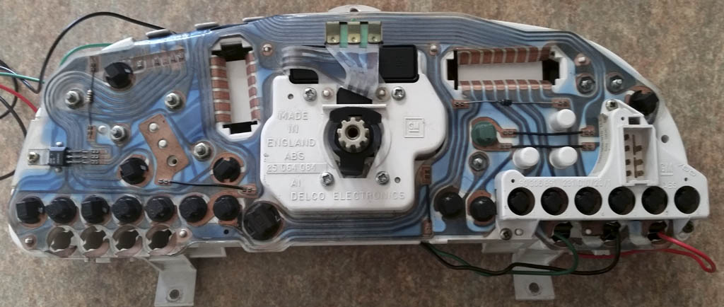

Re: ABS SYSTEM
Postby lotusflasherman » Tue 05.04.2016, 16:16
Specky wrote:Here's a question...
The instrument cluster housing, is it bespoke to the Elan?
I'm aware of the Calibra connection for the dials etc... But the only Calibra photographs I can locate have a subtle differences in the housing, most noteworthy is the area below the three gauges?
That dam ABS light cover's still troubling me :roll:
A friend had a MK 3 Cavalier SRi with same instruments as Elan except marking in white, not orange. SRi had two tiers of telltale lamps each side ... :bonk: Picture is better than me going on!
Think Calibra was same as Cav SRi but many more SRi's made.
Re: ABS SYSTEM
Postby Saltire » Wed 06.04.2016, 07:57
lotusflasherman wrote: A friend had a MK 3 Cavalier SRi with same instruments as Elan except marking in white, not orange. SRi had two tiers of telltale lamps each side ... :bonk: Picture is better than me going on!
The Elan also has the two tiers of warning lamps - or at least my S2 does. The lower tier has no bulbs and is blanked out by the warning light mask, which spans both tiers. When I had my instrument panel out a few weeks ago, I did idly wonder about making use of them. However, it would be a big job, because you'd have to find and wire up new connectors for the back of the instrument panel. Instead, I elected to use a couple of the free spaces in the top tier. Much simpler.

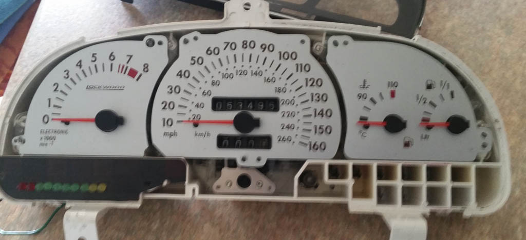

Re: ABS SYSTEM
Postby lotusflasherman » Wed 06.04.2016, 13:52
Saltire wrote:The Elan also has the two tiers of warning lamps - or at least my S2 does. The lower tier has no bulbs and is blanked out by the warning light mask, which spans both tiers. When I had my instrument panel out a few weeks ago, I did idly wonder about making use of them. However, it would be a big job, because you'd have to find and wire up new connectors for the back of the instrument panel. Instead, I elected to use a couple of the free spaces in the top tier. Much simpler.
"Went to see the Doc about my memory and he said I'd got Alkaseltzer or something like that.. can't really remember.." Think that joke applies to me...
SE has two banks of telltales too. On my SE on SORN I have a Manual Boost Control and wanted to know what the fuel air ratio was so fitted an LED display driven from a Lamba Sensor in the turbo.
I used the lower tier for the LEDS but seem to have forgotten that. :bonk: (It's over 10 years ago so that's my excuse. :lol: )
I think the only differences between Elan & SRi/Calibra is the black plastic front with clear screen bonded on where Elan has square holes for the telltale upper tier only; the masks over the telltale lamps where Elan has LOTUS on the unused hidden lower tier, and the function of some telltale lamps is swapped around.
Now, if the masks were produced for the Elan and it has ABS on it that's more evidence somebody at Hethel was thinking about ABS on the M100. That would probably make much more sense than fitting Aircon on a convertible. :lol:
