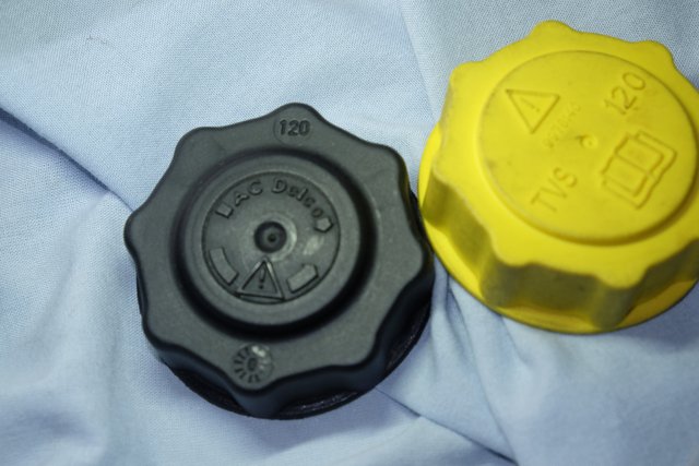

Postby chrism » Tue 08.08.2023, 12:55
I'm fairly sure my black one's an original. It has '120' on it (I suppose the unit is centipascals cPa?)
I'm keeping it in my glovebox as a spare since the newer yellow one seems to be substantially-made and is doing okay atm...
RonR, I reckon the push-fit into a small lip, with no glue or any other means of location should still work IF there are enough threads inside the cap to tighten it down sufficiently.
Perhaps not-enough-threads-to-tighten-it-down-fully might be the issue here?

I’m running what is definitely the original black cap on the S2. There’s no record anywhere in the service history of it being changed. This one says it’s rated at 120, and there’s no part number on it.
My yellow cap, which came as a spare with the new header tank but has never been used, is also rated at 120, and there’s a part number too. They both appear to be the same depth, although I’ve not had the micrometer on them to check.
I’m sticking with the black one for now - if it ain’t broke . . .
