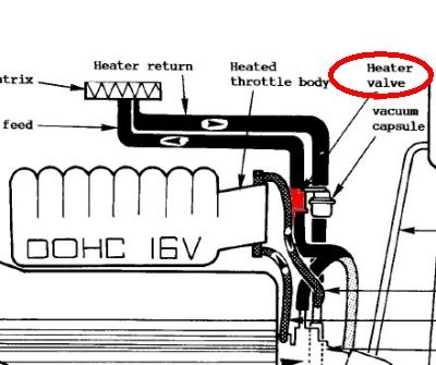

I think the cooling system works perfectly well, assuming it is not faulty: it is merely the gauge that does not read in a linear manner. If you do an Elanscan and look at the actual temp readings rather than relying on the gauge you will probably see it is not "overcooling".
If the heater is not giving enough heat there is probably a problem with the heater matrix or the heater control valve: hopefully the latter. These are easily replaced with a non-rusting plastic Volvo sourced item: see WikiLEC. If it is a blocked matrix, give the system a good flushing and hope it clears. If not it is matrix out: I think epipete did a posting on this at some time.

The coolant is allowed in to the Heater Matrix via a valve (as John mentioned above), this can be located between the coolant header tank and the plenum (from this you should find two pipes leading through the bulkhead (to the matrix)). If you disconnect these pipes you can flush the matrix out and check the condition of the valve. This will determine if a blockage is the cause.
The other reason for lack of heat is that various vacuum pipes are used to activate various settings on the heater flaps (in addition to activating the aforementioned valve). You will need to check that you have an appropriate vacuum; but in the first instance (while I dig out the proper thread :bonk: ) if you run the engine to warm (heater set to cold) and check the temp of the two pipes leading through the bulkhead they should be cold as the cold setting operates a vacuum which closes the valve, get someone to operate the heater to hot and watch to see of the Valve automatically opens. Either way you can now open the valve manually (if setting to hot didn't work) and you should feel the pipes getting warm (and then hot) as water flows through!

Thanks again for the replies , decided to start from the very beginning and replace thermostat (again) this time with one from a different source, local motor factors .The stat came a box marked FIRST LINE complete with assortment of gaskets. and it looked to be made a little more substantial/accurately made compared to the one removed which I had installed a while back. Things are better, more heat but still the gauge reads only in the first quarter for normal driving but now in the high part of this quarter not as low as before . This would seem to support Fredjohn when he advises that the gauge calibration is not linear , a small move in gauge reading representing quite a few degrees of an increase in temperature. I closely examined the stat which I removed , discovered it never really totally closed because of poor engineering , the copper valve was not square in the stat housing (visible at the base where the copper valve part is not central in housing) and was never able to seal itself . This was the type of stat with a notch as an emergency vent , cannot see any mfg. name the only marking is the temp marked on steel side not copper base as on the new one. Cabin heat now satisfactory not quite as warm as a modern but a real improvement.
