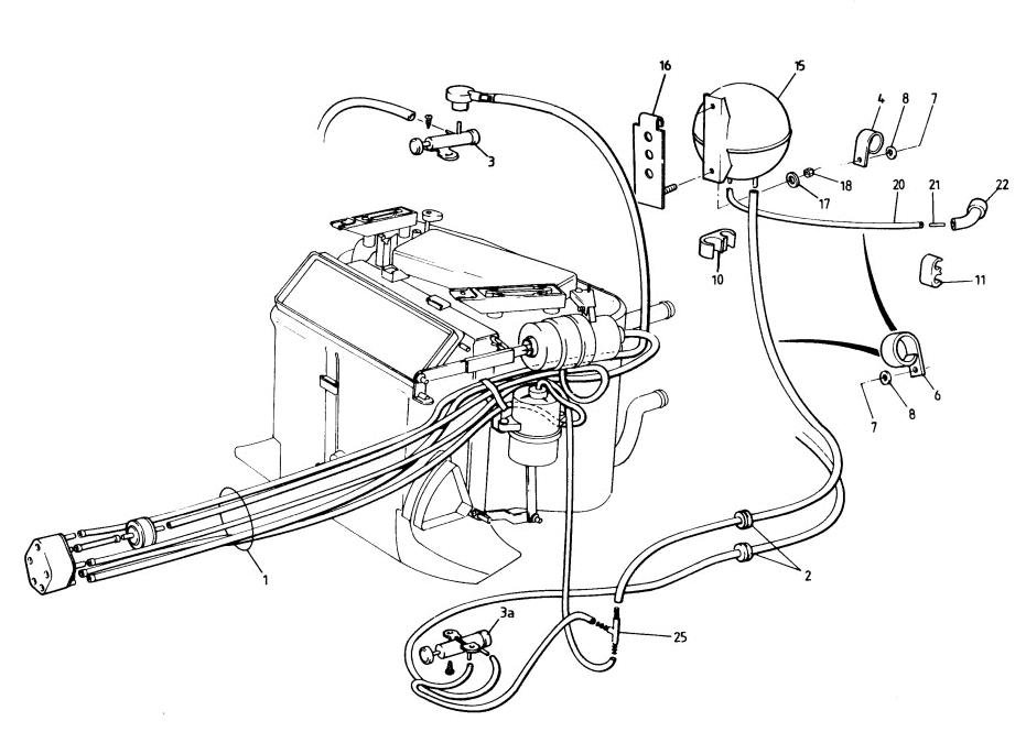

Postby Brit-Car-Nut » Thu 05.04.2018, 06:07
Is it in this picture?

Postby HJ2 » Sat 14.04.2018, 13:01
I'm at it now, but hose 20 is NOT 5mm :(
Hose 2 fell right off the reservoir! :shock:
