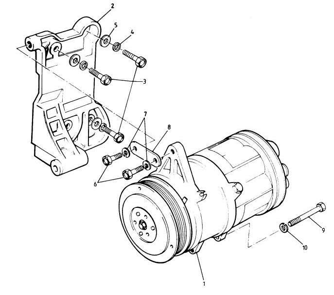

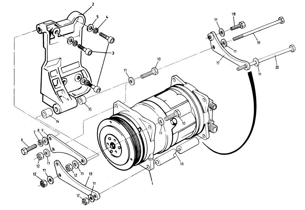

For anyone not understanding the R12 vs R134 comments here are two pictures:
This is the R12 Compressor and mounting
This is the R134 Compressor and mount

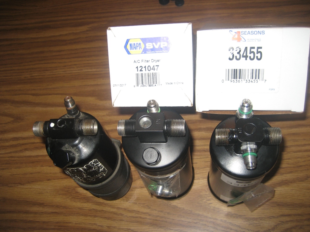

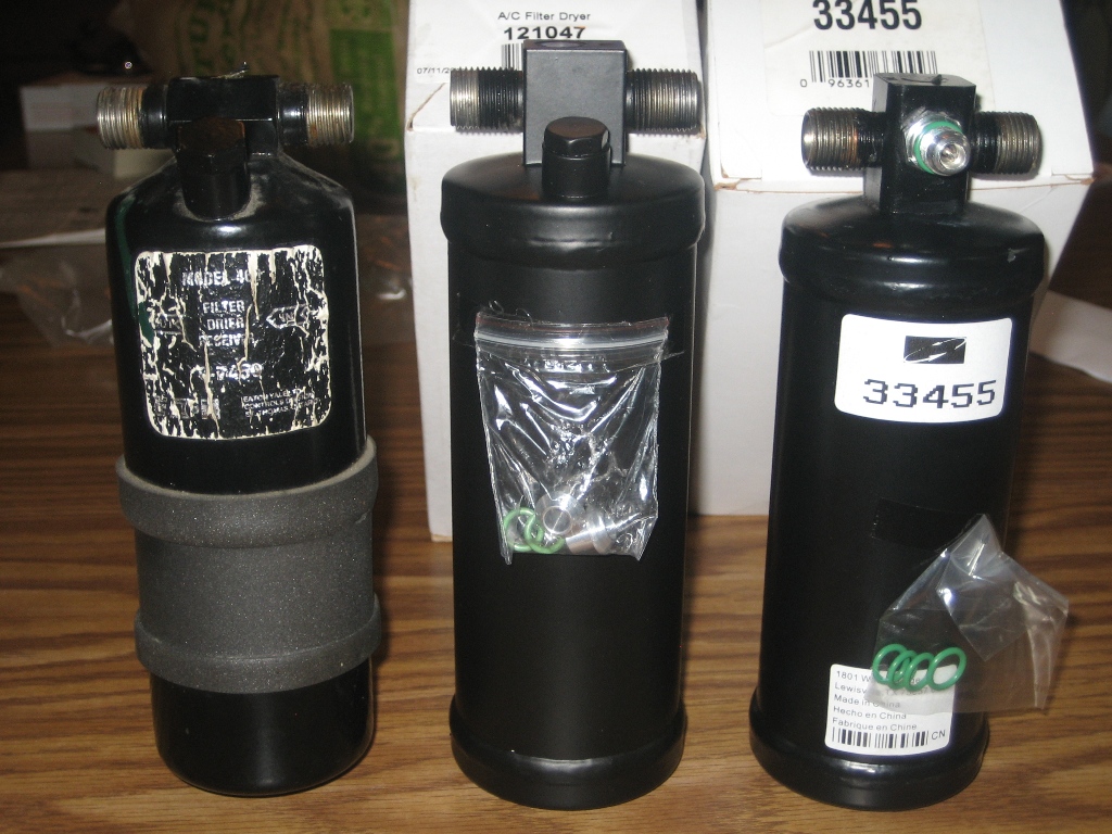

as followup, here's the A/C dryers I found available and what works.
Starting from the left is the original equipment as pulled from my M100, however i've been told by other LEC members that this is NOT original OEM, but rather a replacement. It is an Eaton Yale model 406 part #0-7450
The middle unit came from Napa part#121047 which was a cross reference for the Parker #085268-03 unit. It is nearly a perfect match and will be used for my car. The "in" port is on the same/right side, the schrader valve for "hi/lo" sensor is at the top. the size, shape, width and height are nearly identical.
The far right unit came from RockAuto using the Four Seasons part # 33455. it is somewhat different in that the extra "plug" is another schrader valve AND the "in" side is on the left this time, contrary to my setup in my car, so we opted NOT to use this one. It is also nearly exactly the same shape, width, size, but just a tad shorter. If i wasn't able to get/use the Napa version, I would adapt this to work for us.
UPDATE as of July 17th, here's a twist. I thought the Napa part was to be used, but the mechanic found it a tad too long AND it wouldn't fit in the clamp since the body weld of the dryer unit is at the bottom. The original Eaton Yale dryer had the weld half way up the can (smaller diameter bottom half, larger diameter upper half - can't see in the picture due to the rubber cushioning band covering it).
SO, in the end, the mechanic chose to use the Four Seasons dryer and cap off and ignore the extra schrader valve.

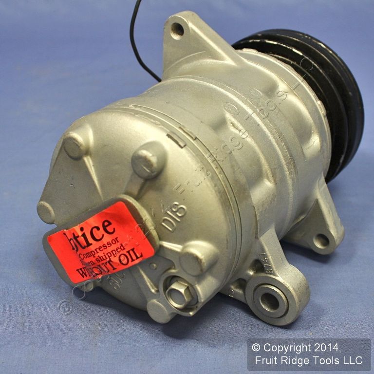

Postby tedtaylor » Sat 15.07.2017, 00:23
Fellow LEC member "Wayne" pointed out that i failed to show/list the A/C compressor I was able to get.
I found one on Ebay. it's a Reman Frigette 204-1221 #R060103B came out of Jamestown, New York, USA for $89 bucks (free shipping). Says the application is for '86-'89 Chevy Spectrum, but it only has the single pulley, so you'll have to change out/retain your original 6-groove pulley and electro/coil pack clutch OR you can change over the other 6-groove pulley over to a single V one. I was able to change over the clutch. You will have to use a "special GM" clutch removal tool, not just any puller.
The Ebay listing says there are three left to purchase.
