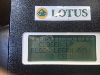

The CEL is not on but Fault Code 13 is stored. I have an original Lotus Tech 1 tester and the only readings which are out (after the fans have switched on and off 3 times) are OXYGEN SENSOR which remains constant around 457 instead of varying between 50 and 950, and, OPEN/CLOSED LOOP which naturally remains OPEN.

To check: you can see the sensor and its wire to the left of the turbo. Also look at your Tech reader, it may tell you the chip. 9929 or 9930 are SE no sensor, 1499 S2 with sensor.
I suspect that as the O² reading is constant and it is saying OPEN, you have an SE with no sensor fitted.

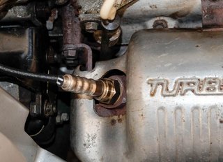

An easy check:- If you can confirm that you've got one of these
then your O2 heater circuit may be broken* in some way.

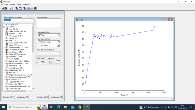

Postby chrism » Mon 20.02.2023, 17:39
Thanks FJ.
Erm...I meant red alternator light that goes out when we start up and flashes if we aren't ticking over fast enough. Is that connected in any way to the O2 feed? I gathered that it provides a heater circuit/current when it goes out as the engine fires up. If there's a parallel connection does that mean that as the red light dims the current diverts to the heater circuit, I wonder?
Also, yes I agree the 1499 map should denature the CO pot input (situated near the ecu) - but my EScan gives me a couple of 'O2 sensor graphs' vs Time(s) (picced)
This is 'CO potentiometer/Oxygen sensor':
and this is 'Oxygen sensor (integrated)':
This is the coolant temp graph for comparison with 'closed loop' opening: (admittedly scale could be better...)
As you can see they're all from the 1499 map data... :?
ps I'm just noticing that the 'closed loop' start up seems to occur even before the 'stat opens... :shock:
pps the last bit of the graph is where I started up and moved the car into the garage half an hour later or so

The heater wire is easy to check: remove plug from sensor, switch on and run a multimeter to earth. Should read 12v.
The signal wire may be more difficult. Continuity check between plug and the plug into the ECU should do it. Hopefully the ECU is OK!

Yes, Simon_P. If we superimpose the O2 sensor/Coolant temp graphs previously posted it'd support your figure and show a switching point of between around 50 - 60C after roughly 100s. Certainly before the 'stat fully opens.
(It would be easier to compare if we could overlay these graphs for greater accuracy in the same way that we can overlay separate EScan maps/files ...)

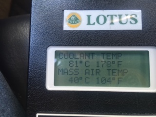

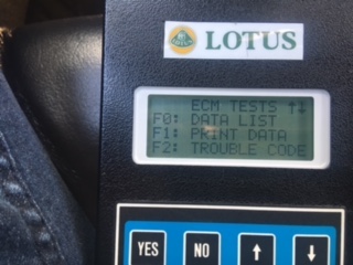

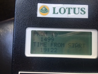

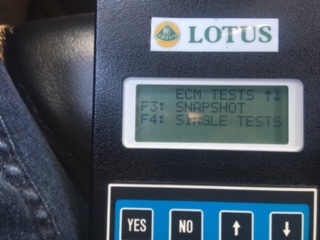

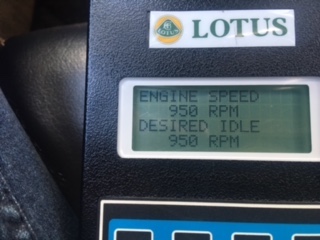

I have attached some photos of Tech 1 in use. It reads 34 parameters and allows us to switch solenoids etc. on and off.
Once again many thanks for your support. I'm sure I will be contacting you again in the future.
