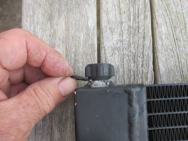

So, four years after being clobbered by a half brick and a load of random drips later, I found a big puddle on the garage floor after going up to see Nev's XJ13 so time for action:
Fearing the worst at what I found:
But no, it turns out it was the poxy bleed screw all along... that and the tapped hole not being plumb with the mating face, so there was room for leakage despite being screwed fully home. Filed square and Dowty seal and blue Hylomar to the rescue.
The hole in the metalwork doesn't exactly line up either so maybe vibration as well as thermal expansion caused the random nature.... One for the todo list.
After a few scares (hose dripping at the water pump), bleeding coolant slowly dripping down the rad and appearing on the floor overnight and water from the bonnet hinge area spilling on the floor when I let the jacks down.. she seems watertight so Brands Hatch is on.
Hopefully the oil leak is just because I pushed the oil pipe inadvertently.
Oh and if you ever get around to fitting Gordon's fans after 8 years (well I've been running one OEM for 4 years as Gordon's needed some fettling which I didn't have time for when I replaced the rad) don't try to be too clever like me and fit full 3mm grommets as they just distort the housing and the fan blades catch.
Finally, WTF is this? I found it in the bucket of old coolant and it's obviously been in the cooling system for some time!
Re: New Radiator Needed - Is it a GM part?
Postby peteoddcar » Tue 23.08.2016, 17:30
That is obviously the Gremlin's hat, he probably left it when he ( she?) made the bleed plug leak intermittently for years. :?
