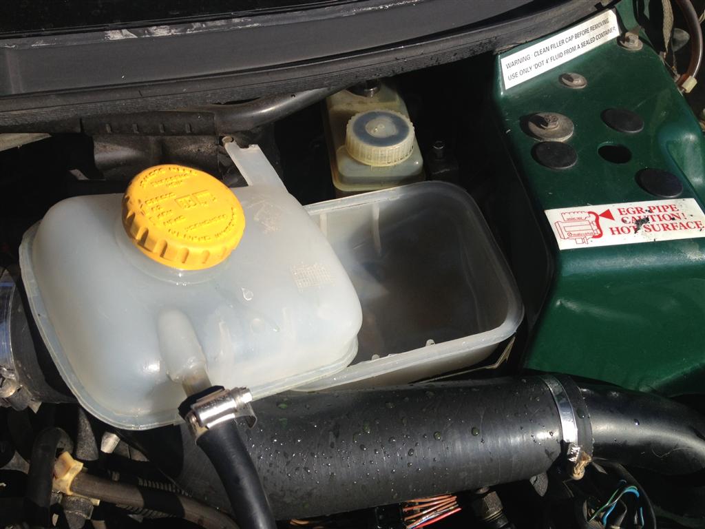

Postby superbad » Tue 05.03.2013, 23:15
I'm so f**king sick of the cooling system on this car. Tank and cap were ~3 months old.
Symptoms- heater has been flaky at idle, today it went flaky at all RPMs. Engine temps started running highish. I guess water pump or belt would be suspect, they are only about 3 years old though. Thermostat was replaced a couple weeks ago. Temperature got to the top of the gauge for a couple minutes and the tank exploded about 5 blocks from my house. Obviously either that cap is doing a bang up job of venting pressure, or these tanks are dogshit.

It was such a clean break I was able to bond the two pieces back together with 3M DP8005. Went back to the black Lotus cap too. Hopefully that lasts until SJS gets the aluminum ones made again (it's probably better than the original bond actually). Not sure what was causing the initial overheating, may have been an air bubble or something. Just ran it all the way up to temp and it was fine. Thermostat is opening, water pump is pumping, heater is heating, fans come on and the temp drops, etc.
superbad
Posts: 427
Joined: Sun 28.12.2008, 06:02
Location: Denver, CO
Re: Coolant Tank Replacement
Postby superbad » Fri 08.03.2013, 02:55
I can now report that DP8005 is not up to the task. :lol:
