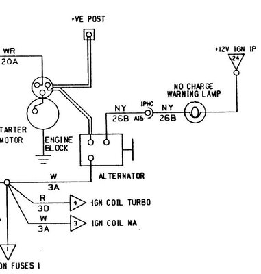

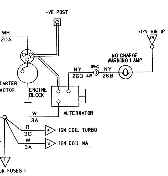

I'm no expert in how it works but the logic as I understand it is.:alternator wire provides a ground when the engine is not running and the ignition is on so current flows through the bulb and it illuminates. When the engine is running and the alternator charging the voltage on both sides of the bulb is the same so the no current flows and the bulb does not illuminate.

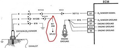

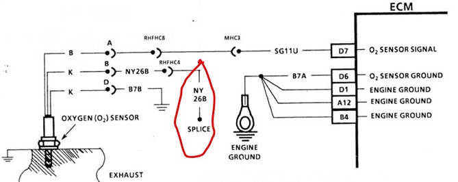

Reading the wiki description it looks like the O2 wiring diagram is causing some confusion. It needs to be read in conjunction with the alternator wiring diagram. It is then aparant that the O2 heater is connected to the alternator by tapping into the no charge light circuit.
It appears that the no charge bulb is being grounded through the O2 heater, which would suggest that there is no/insufficient current supplied by the alternator connection.
With the O2 sensor disconnected, ignition on, engine not running does the no charge warning light illuminate fully? Or not at all?

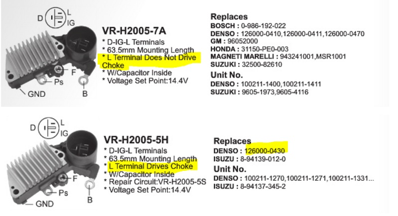

Its been raining here all morning, so I used the time to research into the alternator regulator which controls the Charge Warning light (and powers the O2 sensor heater where fitted i.e. S2 Elans and SEs that have been modified for closed loop ).
Its not uncommon on this Forum for replacement alternators to give a constantly lit Charge Warning light. I had this problem in 2019 when fitting a new SJS alternator, I didn't solve the problem and ended up refurbishing the old original alternator with one of Simons refurb kits (which worked without problems) and put the new SJS alternator in the spares box.
So today I pulled the suspect SJS alternator from the spares box and opened it up to find the regulator marked with part number 'VR-H2005-7A'.
Checking old posts on the forum and the inter web for equivalents, I found that the original alternator was fitted with Denso regulator 126000-0430, that equates to equivalent 'VR-H2005-5H', so not the same as the part fitted in after market alternator.
Comparing the two regulators:
This shows the pin configurations are the same D-IGN-L (where D = Dummy (no connection/no sense connection)), but the L connection (Lamp) has different functionality. The original (-5H) has ability to drive a 'choke', whereas the -7A does not have that ability.
Searching the web finds that the 'choke' refers to the ability to power additional circuits eg choke relay/solenoid at start-up.
So this would imply that Elans with O2 sensor heaters, which need about 1 Amp, really do need the correct regulator VR-H2005-5H or direct equivalent. A regulator that is not spec'ed to drive Choke will probably work in an standard SE but not in an S2 or O2 sensored SE.
So I have now ordered a replacement VR-H2005-5H regulator to fit in the SJS alternator - then I will have to decide if it goes back in the spares box until needed or take the pain in fitting it just to confirm that it is a good fix.

Hi, I cannot give a straight yes/no answer - the need for a VR-H2005-5H (or direct equivalent) is when the car has an O2 sensor, this regulator type can drive the added load of the 02 sensor, so this would normally be S2 Elans, but if your SE has been modified with an O2 sensor then it to will need the VR-H2005-5H style regulator to satisfy the added load it applies to the regulator. If your SE does not have a retrofitted 02 sensor then your problem may well be due to some other issue, but still quite possibly related to the regulator since there are not many failure modes with so few connections to the charge lamp, so changing the regulator for either of the variants may well be a fix:
(and for reference, the 02 sensor connection to NY26B is only valid for S2 Elans or modified SE Elans:
