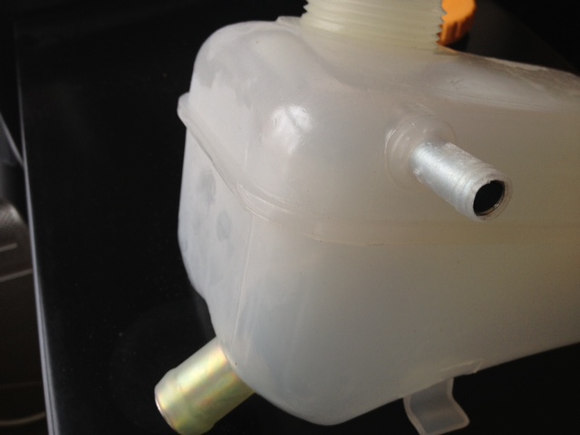

Just got another one today- this one is made by Vema (p/n 16380). Looks stouter than the ones we have been getting. Hard to say for sure, but appears to be a single piece molding- it doesn't have an obvious bond line between the upper and lower sections. Seems thicker too. I'll let everyone know if it explodes. Came from here:

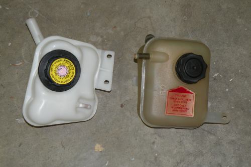

I joined the coolant tank club, but my failure was at the smaller junction on the top of the tank. I attempted to source one from Dave Bean, but they no longer carry them. Removed the tank and made a trip to my favorite parts store (Allied Auto Parts, Fremont CA), told the guy behind the counter that there was no chance he had one but might he suggest something "similar".
He commented that it looked quite like the tank in his 1993 Saturn SC Coupe. I had him open a box, saw them side by side and decided I could make it work.
It took a little bit of modification to the tank and fabrication of a bracket. Not difficult work but simply several hours worth. The final result is "reversable" and looks like this:
If anyone wants more detail about this, let me know and I'll post it.

Thanks, Steve. I was impressed by the design of the tank. It has a great deal of internal, structural members that should give it strength where the Lotus tank did not. Also, looking at the Lotus tank, there appears to be what is called a weld line right in that area where folks have reported failure. I did attempt a repair of the original tank, which probably was successful. But the new tank seems to be the better option. For those who are interested: it is a Dorman 603-121.

After a month of running, the Vema tank is holding up great.
http://www.ebay.com/itm/120964805362?ss ... 1439.l2649

Postby Brit-Car-Nut » Tue 28.05.2013, 19:04
I purchased around 10 over the last few years and as soon as I got them, others needed them and I passed them on. Nobody has complained except for DBE who got one recently and sold it only to have the buyer say it blew up immediately.
I am still convinced the tanks are fine but if there is a problem with head gaskets, cracks or bad pressure caps, then nothing will stand up.
I picked up 10 more last time I was in the UK (and let Graham have one for my cost) but I don't dare sell any others since I have no warranty recourse if a tank fails.
One of these days, I will run a proper pressure test on one and see what I need to do to blow one up.
BTW, both eBay links are for the same company.
